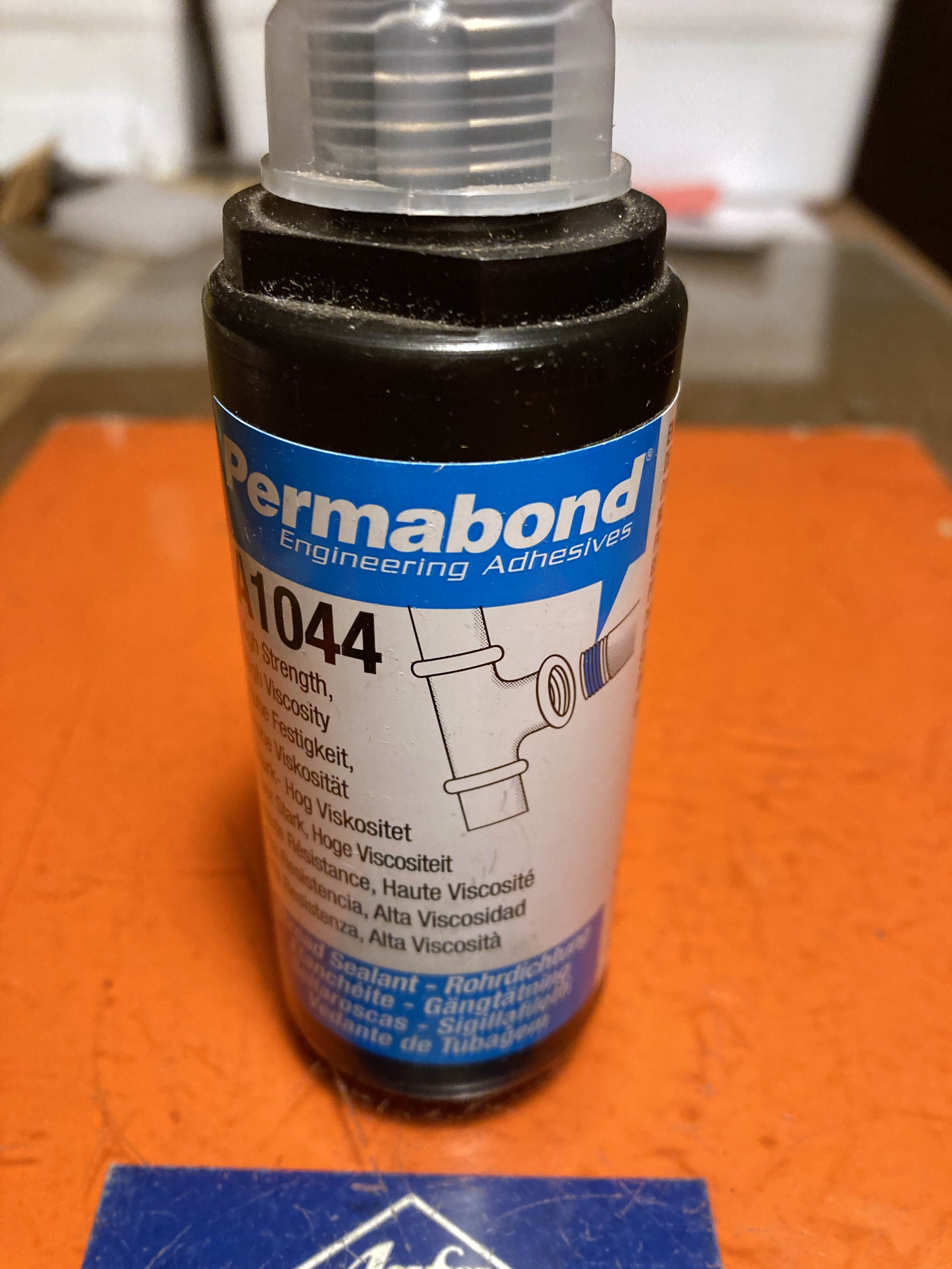

This will do the job perfectly (I know by experience)...
