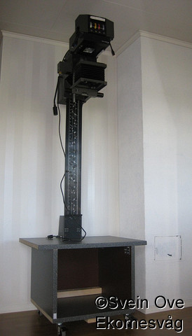

I have a LPL 7700 in an under the stairs cupboard with sloping ceiling. My solution is to place the enlarger lower in order to not hit the roof. Mine is now so low I sit cross legged on the floor when I print.
I sit or kneel when I print.
However, I will build some kind of extra baseboard so I can stand when making small prints and remove it when making larger prints.

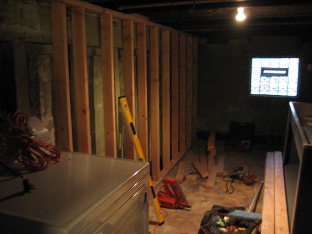

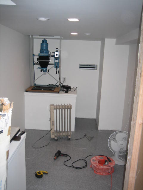

I also had a height issue when i built my darkroom. I decided to frame and drywall an opening into the ceiling joist so the head can get more height and also i put safe lights inside cans in the ceiling, it all worked out fine for me.

Great B&A pictures! I'm building a darkroom myself. The drywall has been a slog; waiting for the tape to dry, the dust from sanding and I'm just not as young as I was when I was young. At times it is disheartening and I feel like I'm never going to get past it. But it is almost done and, for a basement darkroom, pretty damn good. The painting and all the rest will be cake in comparison. I too cut a space up into a joist bay. That gained me seven inches so I'm still going with a table with a drop surface.
Thanks again for the images, they were a pep talk.
