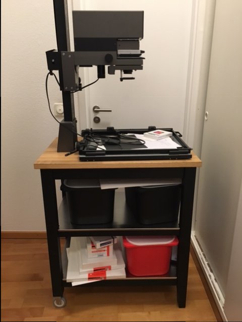

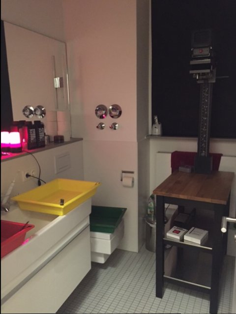

For instance, my GF and I live in a small apartment in Munich. We mounted our enlarger on a cart from Ikea. All the equipment is stored in the cart.
We simply roll it into the bathroom when we want to print, it takes maybe 15 mins to install and the same time to clean everything up afterwards.
(The red box is for chemicals, miscellaneous equipment are stored into the black boxes, and we love Adox MCP310 :smile:)
Obviously, it gets complicated when one of us wants to use the toilet :D

Would I need more space for other stuff? Washer? Dryer?
I wash the prints in the sink which you can see between the red and yellow baths on the above picture.
The sink is perfect for running water. (I am lucky enough to have a rectangular sink large enough for 30x40cm paper!)
In my understanding (others, please confirm) you only need a dryer if you make fibre-based prints.
The dryer will allow the film to remain flat while drying.
We don't have one and for this reason limit ourselves to resin-coated paper. (would love to try fibre some day, though,
but just stocked a few hundred sheets of MCP 310 in various sizes a few weeks ago).
We let the prints dry overnight on our clothes dryer rack, it is large enough for the output of one evening.
The prints stay flat, no problem.
