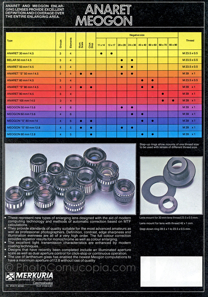

From Photo Cornucopia's list of enlarging lens. If you can find a Belar, it's 6 elements in 4 groups, the Anaret as mentioned is 4 elements in 3 groups. I use a lot of 4 element lens which do fine up to 11X14 inches, these lens were optimized for smaller to moderate size enlargements more typical of a home darkroom. I also have several 6 element lens that I use when printing 16X20. In general I think Meopta dont get the level of respect that they deserve. Of course buying used is a lottery.
Meopta Anaret 4.5/30 4-3 13x17 N M23.5x0.5 [17]
Meopta Anaret 4.5/50 4-3 24x36 N M23.5x0.5 [17]
Meopta Anaret S 4.5/50 4-3 24x36 Y 4[24] M39x1 Square aperture [17][24]
Meopta Anaret 4.5/80 4.5, 5.6, 8, 11, 16, 22[22] 4-3 60x60 N 6[22] M23.5x0.5 [17][22]
Meopta Anaret S 4.5/80 4-3 60x60 Y M39x1 [17]
Meopta Anaret 4.5/90 4-3 60x70 N M39x1 [17]
Meopta Anaret 4.5/105 4.5, 5.6, 8, 11, 16, 22[23] 4-3 65x90 N 8[23] M39x1 [17][23]
Meopta Belar 4.5/50 4-3 24x36 N M23.5x0.5 c. 1964[96] [17][96]
Meopta Belar 4.5/55 24x36 c. 1964 [96]
Meopta Belar 4.5/75 4.5, 5.6, 8, 11, 16, 22 2 1/4"x2 1/4"
[96] N 4 M23.5x0.5 circa 1964 Square aperture [pc][96]
Meopta Belar 4.5/105 4.5, 5.6, 8, 11, 16, 22 2 1/4"x3 1/4"
[96] N 9 [26][96]
Meopta Belar 4.5/180 5"x4" circa 1964 [96]
Meopta Belar 4.5/210 7"x5" circa 1964 [96]

The Meopta Belar lenses were Meopta's budget lenses. The Meogons were their quality 5-6 element designs.
The Belar is a Tessar type lens, like the Anaret and Anaret S. The Meogon is (mostly) 6/4.

Yeah, I mixed up the 2, I have the Megon 50, have not used it much as I have 6 element Schneider 2.8. Also have Belar 75 4.5 which I dont use at all as my Wollensak 75 is a bit shaper. Both the Megon and Belar came with a Metopa enlarger which is storage, about ready to pull it out and swap with a LP 6700 that I for color, prefer the rangefinder feature on the Metopa and glass negative carrier for 35mm black and white.
