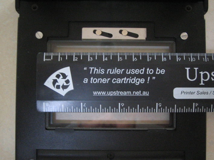

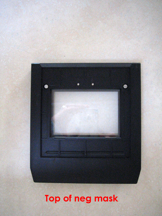

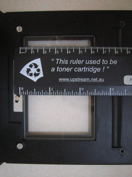

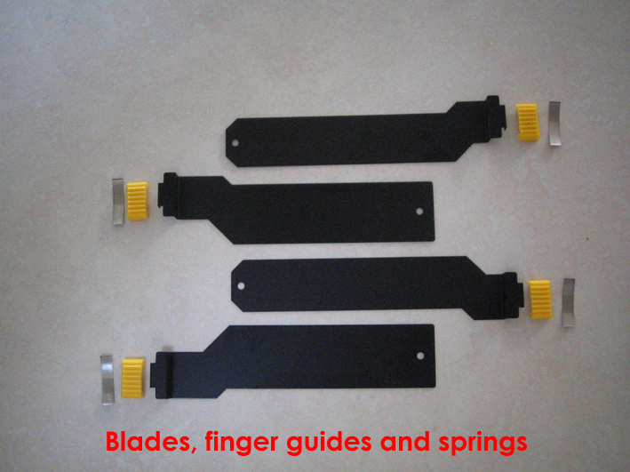

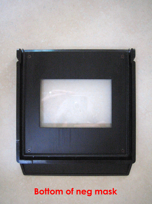

Adapt Your 6x7 Universal Neg Mask for 6x9 Negs
Ok, sorry for the delay - snowed under with work since I arrived and only just had a chance to photograph the neg mask for you.
  1. Ease the yellow finger guides off the blades carefully, ensuring not to lose the tiny metal springs; :eek:
  2. Remove each blade carefully so that you don't bend them or scratch the glass;
  3. Store in plastic bag somewhere they won't get lost.
  4. You now have a fully functioning 6x9 neg mask for your 6x9 negs (and 6x7 if you put back together.)
