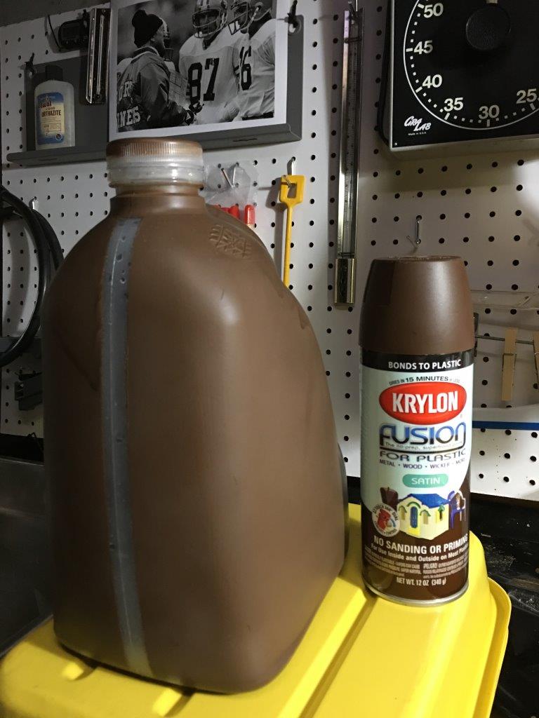

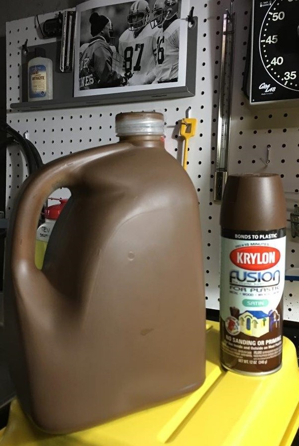

This type of thread may have died somewhere, so time to rekindle the flames.
There was someone asking about containers for storing developer to avoid light getting into it, as alternative to Glass which can of course break.
This is what I am using - Arizona Tea 1 Gallon containers, once they are empty of course. The Arnold Palmer version of the tea on sale is $2.50 a gallon where I live. Other varieties available.
Pros -
Very strong and rugged. Overbuilt compared to water bottles. Thick walls, good resealable cap.
Due to the nature of storing liquid this plastic is very strong against acid, alkali, etc.
The tea doesn't stain the plastic, and cleans out very quickly after it's empty with hot soapy water.
Cons -
The original label is welded to the bottle but is easily covered up with the spray paint. Can you see it?
SOLUTION..
I use Krylon paint, dark brown, satin finish. On this one, I used 1/2" masking tape on one end to see the level of fluids in the bottle. Could also use black satin finish if you wanted. I like the satin finish. Label it with anything you want.
I am also planning buy other Spray colors to color code Fixer, Stop Bath, Toner, Wash Aid, etc...
I challenge other folks to contribute their solutions.

View attachment 165383 View attachment 165384

Wondering about spray painting the plastic tea bottles - won't that eventually flake off?
kreeger
kreeger
Jun 21, 2009
207
Missouri
I suppose it could. This Krylon Fusion paint shown I have used on plastic for 10 years. It's different... "BONDS TO PLASTIC".
Other paint seems to "stick" but not "bond".
