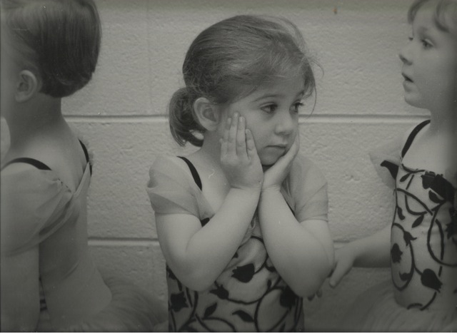

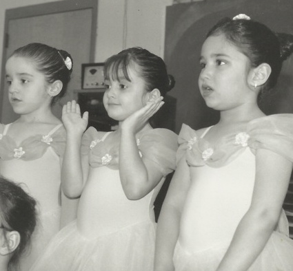

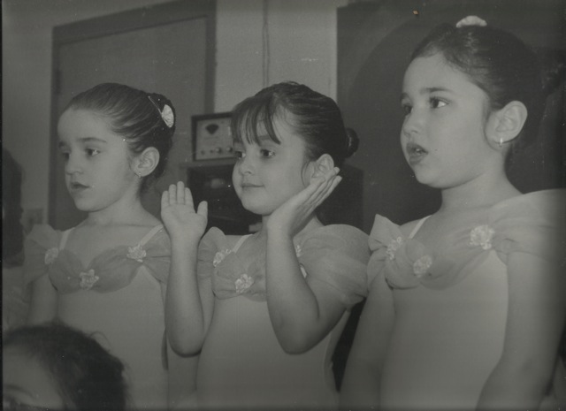

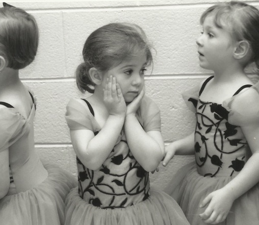

I have committed to producing 12 - 11x14 B&W photos for an exhibit.
I have encountered a problem that I am unable to solve.
Here is what I am working with:
Negatives from IlfordHP5 plus - 400 film
Bessler 23C II enlarger
Ilford Multigrade filters
Ilford IlfoStop bath diluted 1:19
Ilford Multigrade paper developer diluted 1:9
Ilford Rapid fixer diluted 1:9
Ilford MGIV RC Delux Pearl 11x14 paper (Which I've had for more than a year. All chemicals are new.)
I have 4x6 prints from a commercial lab that I am essentially trying to reproduce in my darkroom.
No matter how I change filter, exposure time, f-stop the images
are an overall grey with little or no contrast. Here are two examples:
If anyone can tell me what I'm doing incorrectly, I will be very grateful!

I'd check your safe-light, you don't say what type/colour you're using but that can affect the contrast, it may be too close. PAper keeps at least 7 years under normal conditions (no excessive heat) so it shouldn't be an issue.

Check your safelight first. Once you are sure that it's safe, then try a print with a Grade 5 filter and see what happens. The one of the girl with her hands on her face looks fairly close already. The other image looks like it may have been a little underexposed and underdeveloped.
Might want to shoot the negs on a light box and post a pic. Hard to believe a Grade 5 won't do the trick. You can also intensify the negs in selenium 1:2.

Are the two middle prints those from the lab for comparison or are they all your attempts? I can see nothing wrong with your chemical processing based on your description of it.
