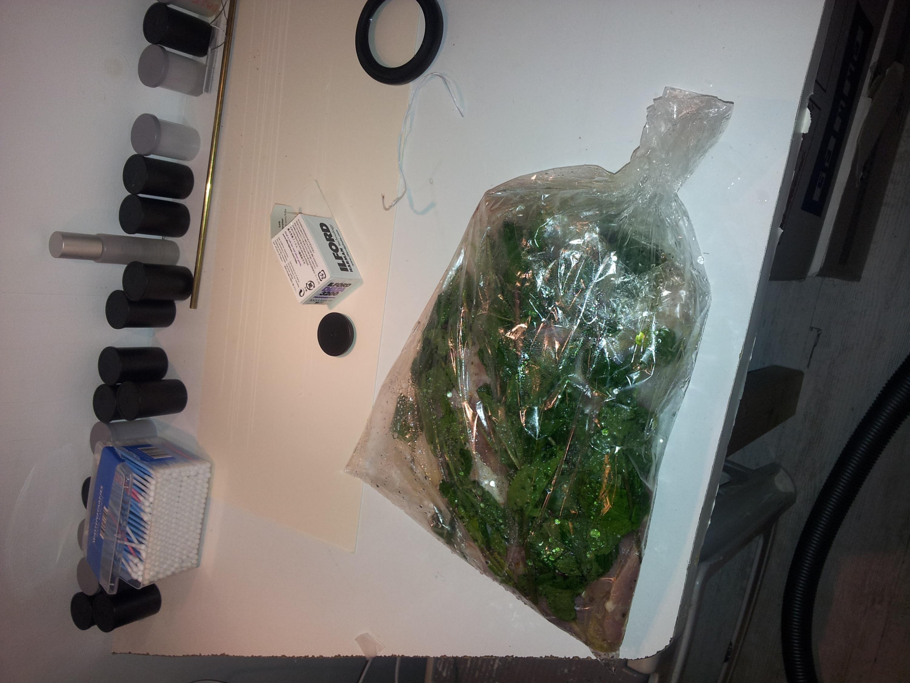

Prepare the lamb shoulder with your favourite herbs and spices; I used garlic, salt, pepper, lemon juice, extra virgine olive oil and lots of fresh mint.
Put the lamb shoulder in a strong frying bag,

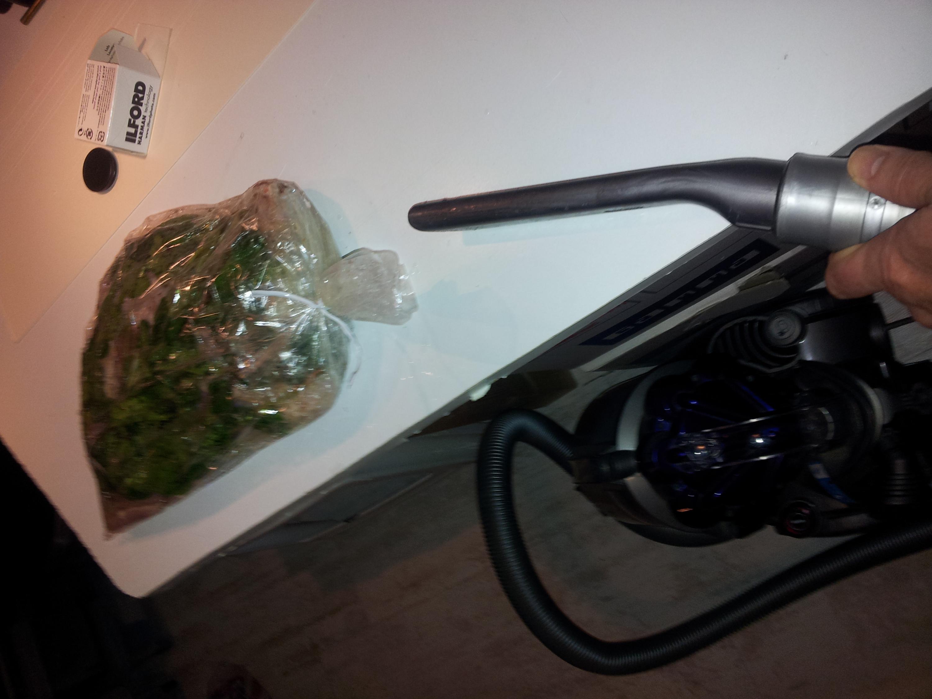

Suck out the air as much as possible - goes fine with the vacuum cleaner. Close the bag tightly.

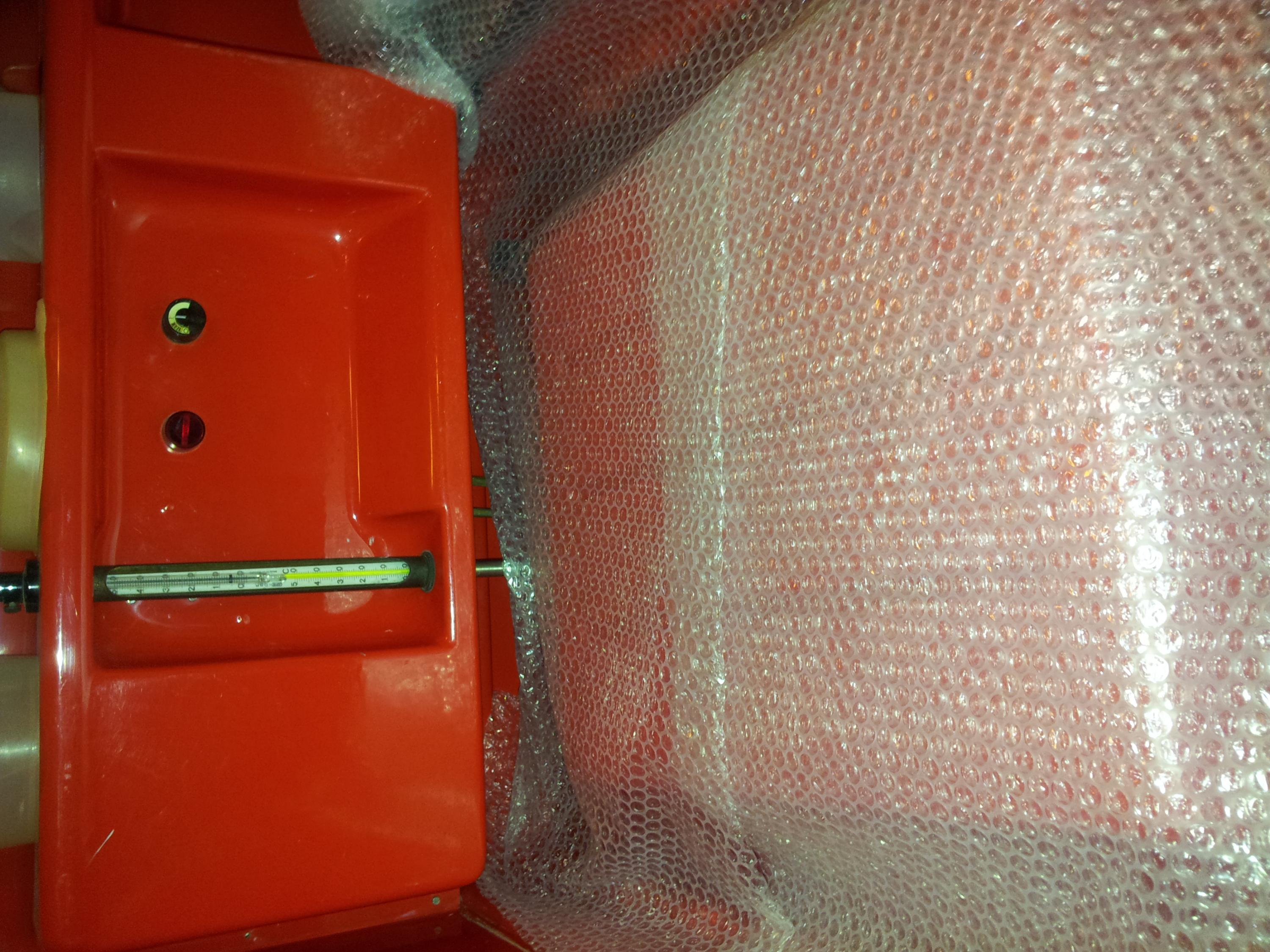

In my darkroom I have a large wet table with 3 basins, one one them with heating, controlled by a PID industrial controller.
I fill up that basin with water.

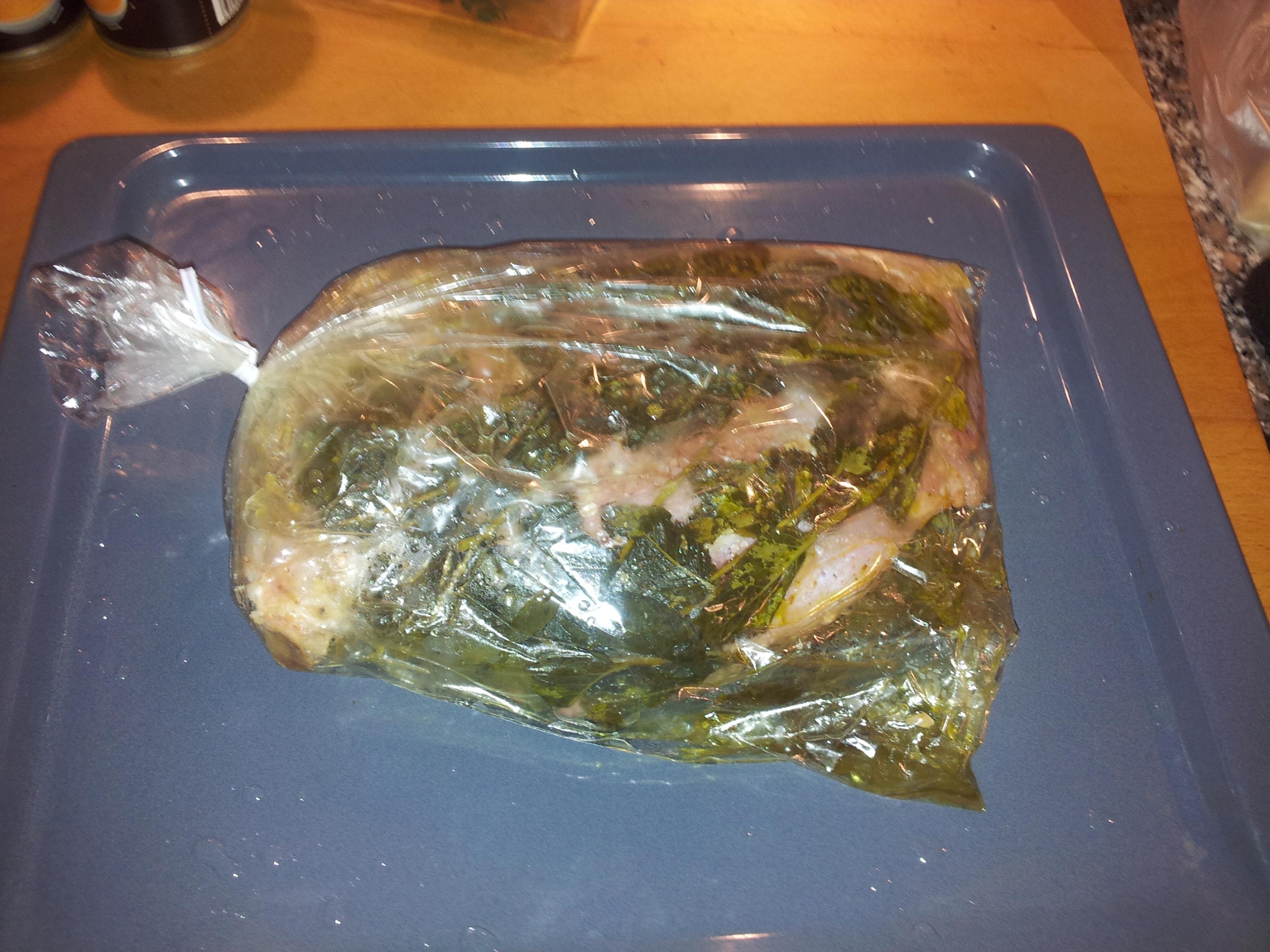

Put the bag with the lamb in a developing tray; for 1 lamb shoulder a 12x16 (30x40cm) tray is just fine. Add some water.
Let the tray float in the basin, heated to 60 degree C.
Cover it with a larger developing tray, floating upside down.
Cover the entire basin with some isolating material; I used bubble-wrap.
Now let it sit there at 60 C for 48 - 72 hours. You should have perfect lamb by then. One may put it under a grill for a few minutes to give it some colour.

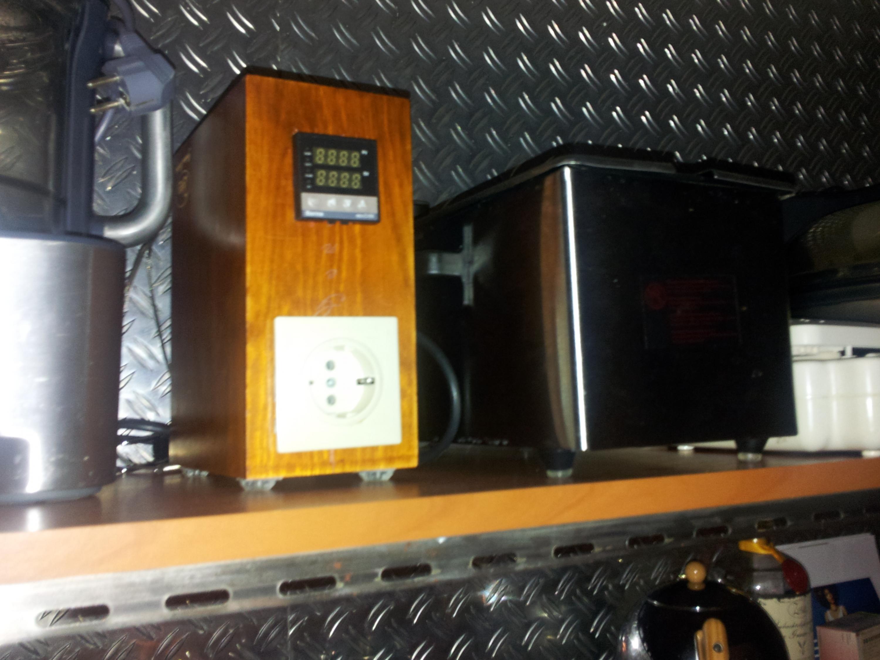

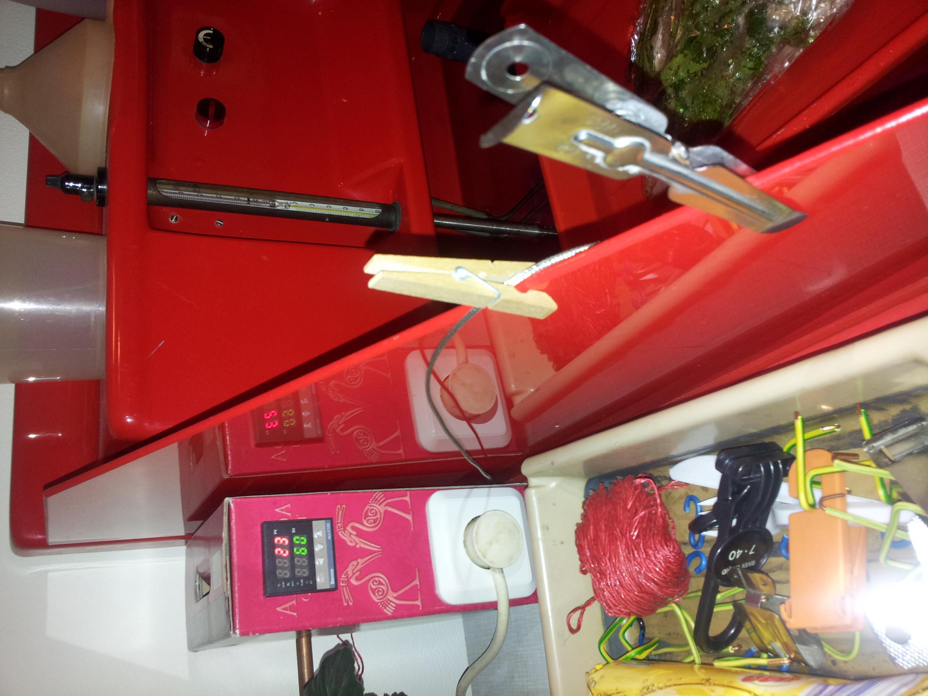

Ron, so your heating installation seemingly is original, except for that controller.
Did you install the controller in a cardboard box ??
You're right: the temperature control of the original installation was way off, so I bypassed that using the external PID controller. I built it into a wine box, reinforced and isolated on the inside. I have another one built into a wooden box from a luxury bottle of Dutch jenever.
