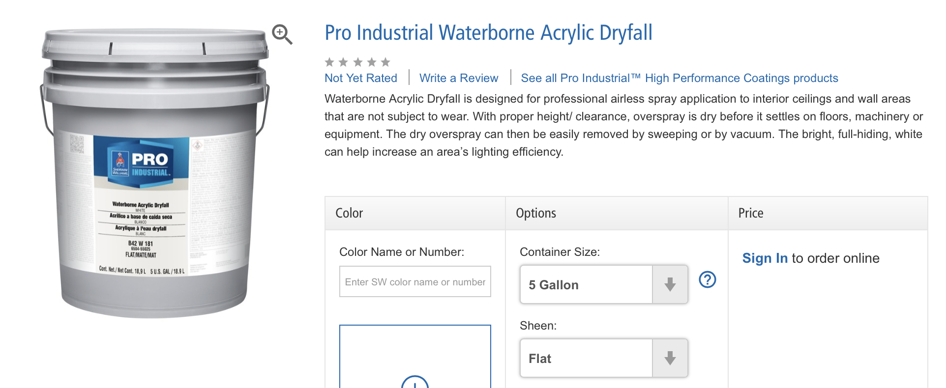

You might consider 'dryfall' paint on the ceiling. That is what I did with the 'office' portion of my darkroom. You can see my dark blind here. You can't see the 8x10 enlarger but it is just around the corner to the left.
I used this Sherwin Williams product in black. It is a little expensive at $250 per can, but worth it. I tried black spray paint first and it did not cover. This stuff covers everything.
