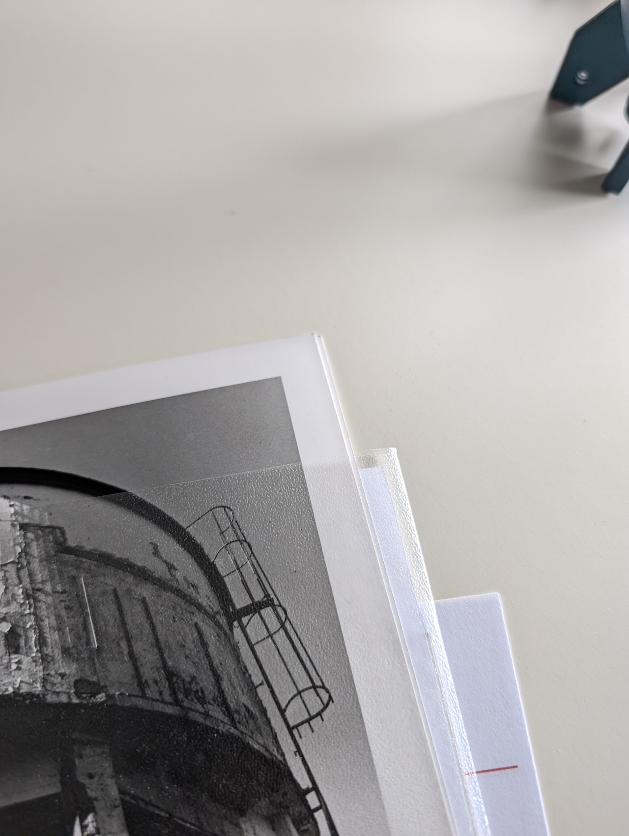

I just opened my first box of Ilford multigrade paper version five (V) and noticed a dark shadow on the edges of the paper after processing it. When I hold it into brighter light it disappears. The paper does not seem to be fogged in general.
Any idea what might be the reason? I noticed that the paper seems to be thinner than the version four paper I used before. Or do I need to fix it longer to get rid of that effect?

Could you post a photo that illustrates the problem, please? I find it hard to imagine exactly what you're seeing.
Thickness of the paper evidently is not affected by fixing, so I imagine that you mean something else than the physical thickness of the paper when you mention the paper seems 'thinner'. What do you mean exactly?

I tried to capture what I am seeing. The first picture is when the paper is a bit lifted so the light from the window does not shine on it directly.

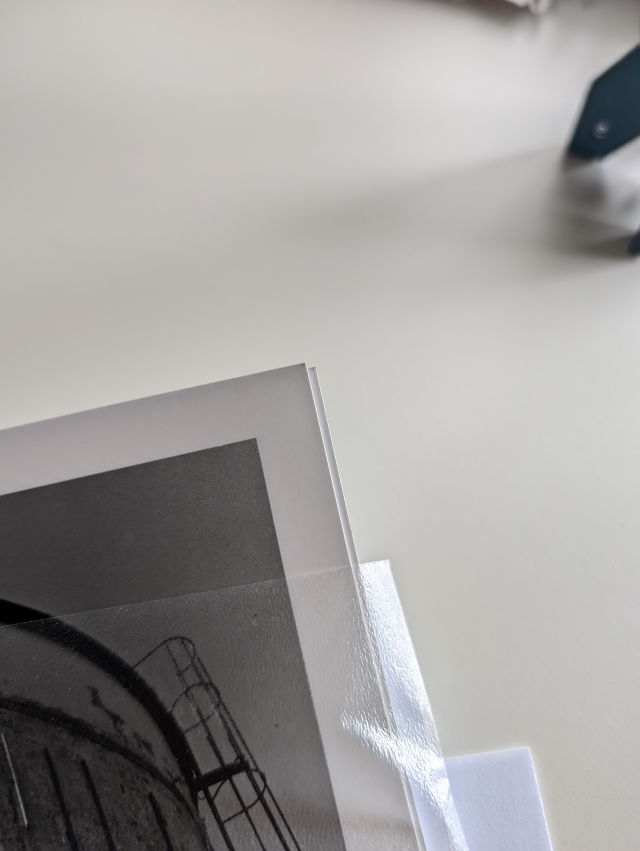

And the second is with the paper lying flat on the table so the light hits it. Here the paper edge and corner looks white. On the image above it looks a bit shabby and dark.

Maybe what you're referring to is just the effect of optical brightening agents, which make the paper look whiter if UV light hits it. Most RC paper bases have OBA's. I don't know if Ilford uses OBA-enhanced base; you might want to ask them. If you mean the faint shadow along the extreme edges of the paper: frankly, I think we're just looking at the shadow cast by a slightly curved upwards edge of the paper in combination with light hitting the paper from the side.
Weird artefacts around the extreme edges of the paper can occur with RC papers if they're subjected to excessively long wet times or an hour or longer. However, this tends to be paired with physical anomalies along the edges where the PE lining starts to delaminate from the base (especially visible when the prints are still wet). I don't see that on your print edges.
All considered it's a very faint/subtle effect; it may help if you manage to find a better way to photograph it. Sorry to be difficult about it; some of these things just don't convey very well on a computer monitor...
