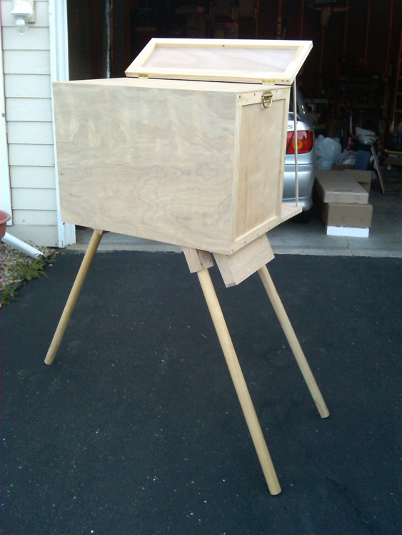

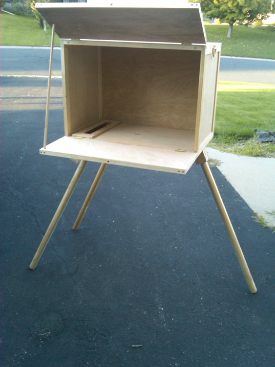

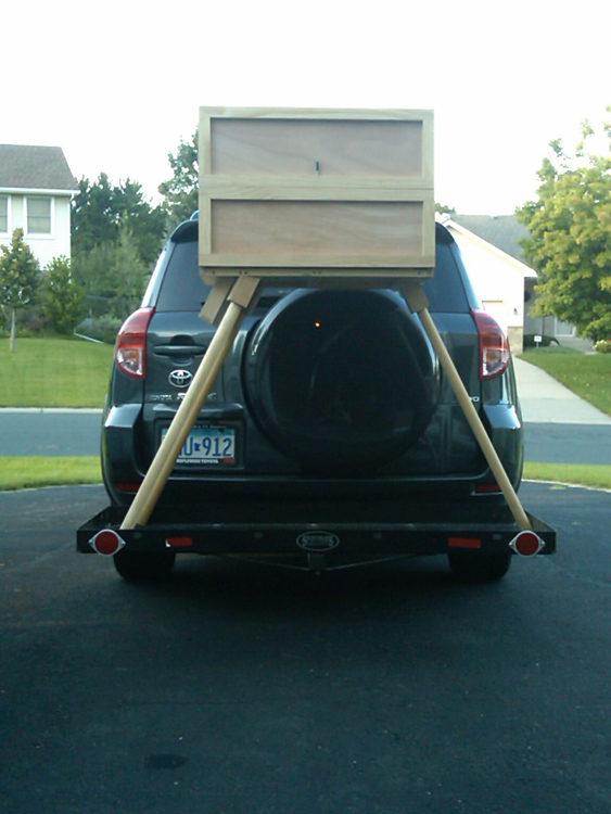

I've not had much time lately to work on getting the wet plate gear ready to go on the road, what with back surgery in June, work and home committments, darkbox sat there gathering dust..... Well until today!!. I am making more progress. All I need now is the shroud and a few coats of spar varnish, and I am good to go!!!
The plan is to set up the box using my hitch hauler when I am on location...
A future plan is to make a 12v RV water pump setup to have power wash for removing developer from plates. I'll have room for 3 x 5 gallon water containers underneath... one for developer rinse, one for drainage, and one for final post fix washing.

Well, it looks very nice, although I'm not sure how it works!
I presume it is midway between a portable darkroom and a changing bag?

Looking good, Andrew! I like the dropped slot for your silver box. Is it built for 8x10 plates?
Andrew Moxom
Andrew Moxom
Feb 2, 2007
4,888
Keeping the
Thanks.... Barry, the sunken silver bath will take a Lund photographic whole plate or 8x10 'traveling' bath as they are the same dimensions front to back, just wider for 8x10. Right now, all I have is the whole plate version. I hope to get the 8x10 one in future.
I was also thinking about making another sunken bath attachment that would allow you to put cool packs in it to keep the temperatures down in hot weather.
I'm also struggling with what color to make the box... white on the outside, black on the inside, or just plain varnish inside and out... Not sure.
