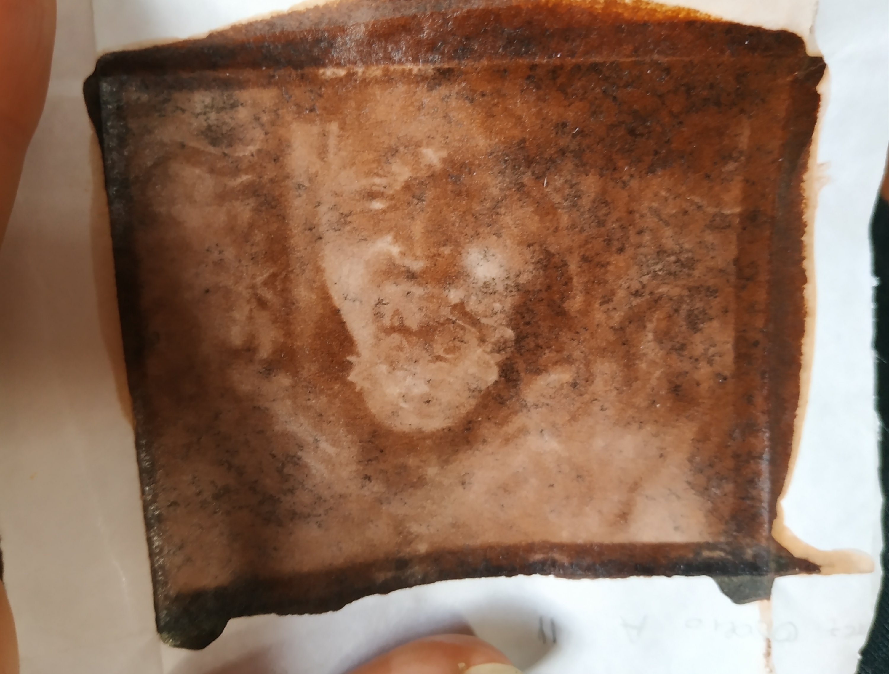

Hi everybody,
I am having the following problem with Albumen:
the print looks great until the final wash. After taking it out from the water to dry, it starts to show these tiny dark spots scattered all over the image, as you can see in the picture attached to the thread.
My paper is Canson Universal sketch pad, double coated and hardened with isopropyl alcohol, not toned, with the classic hypo fix processing.
Has anyone else had the same problem? Any feedback will be greatly appreciated...

I make salt prints, not albumen, so I don't have direct experience with this and I'm guessing a little here. I have made quite a few salt prints on this paper ( it has a nice bone-white color and a nice "pebbly texture"... very good for some prints! ), and I have seen black spots and other problems appear during the final wash with other papers -- it's common ( and frustrating! ) for problems to pop up at the end like that. I have not seen black spots with Canson Universal Sketch, which is probably a good thing, since I always wash my prints for at least an hour and usually 2 hours -- it makes me think your black spot problem might have a solution. When problems appear in the final wash or as the print dries, it's usually because the moisture has reached deep into the paper, under the sizing ( or albumen ) and something has reacted with the internal sizing or the internal alkali buffer ( this paper does have an alkali buffer ).
I can't tell how big your print is, but here's what I'd do. Make some small test prints ( like 5x7 inches -- to save on cost of silver nitrate ), and try extending the first wash before you fix the print. Start with plain water and change it at least 3 or 4 times, keep changing the water until you can not see any cloudiness come off the print any more. Then let the print soak in clean water for 10 minutes, twice. Then wash for 3 minutes in water with a few shakes of salt in it ( a teaspoon per liter is fine ). Then rinse several times and soak for 3 more minutes to wash out the salt water. Only after this long washing, then fix the print in hypo ( and, given your problems, you might fix for longer than before, and using at least 2 separate baths of hypo. ) Finally, a long wash, at least an hour, changing the water every 10 minutes or so.
If the black spots don't happen on your test print, then you've got it figured out. If they still happen, there are some other things you can try. Photrio member Herzeleid has posted instructions for using strong ammonium chloride solution in the wash sequence. I've tried it and it worked very well for me, and it is probably a great thing to try if you are still having problems. Another possibility would be to acidify the paper before you coat the albumen, and/or add a little citric acid to your silver nitrate. But I think you should try extending the 1st wash first, before going to something more complicated. I will go and find Herzeleid's instructions and post a link to them here in this thread.
Make sure there's no chance of any metal contamination ( like an iron pot, or a rusty wire whisk to foam the albumen ) anywhere in your process! That's a well known cause of black spots in salt or albumen prints.
Good luck and have fun.

Oooh, thank you so much for taking the time to share such a detailed response!!!! I think you are right about the moisture getting too deep into the paper because the first way I have to tell if the spots are going to appear or not is holding the wet paper against light, so it looks like the spots are inside and surface after. Next week I'll conduct some tests following your washing instructions and I'll make sure to post the results here.
Thank you again! :smile:
P.S. Oh, I am using medium format film negatives for these prints, so they are fairly small...

Looks like uneven absorbance of the paper and/or albumen layer. Try a different paper or albumen application method and make sure the albumen is sufficiently cured before sensitization.
Hi koraks,
Thanks for your help!! :wink: Just a couple of questions... When you say "sufficiently cured", how long do you consider sufficient time between Albumen coating and sensitization? These pieces of paper have been Albumen coated for over a week before using them.

I would imagine a week being more than enough. Frankly, I gave up on albumen because I didn't fancy floating coating and sensitization, which seemed to be the only route to good evenness. So sadly I can't give good recommendations on papers; all I can say is that I recognize the problems you seem to be having and I feel your pain...:wink:
On a side note, do you use a surfactant in coating or sensitization? Something like tween or photoflo? I found that this greatly increases the risk of this phenomenon.
I might add that my best results with albumen were with hot-pressed fairly smooth papers with limited absorbance; I generally like Schut Simili Japon because of these characteristics; it performs very well with all alt processes I've tried. However, it's a Dutch paper and it will likely be very hard to get on the international market unless you order it from a Dutch outlet. So it's probably of not much help to you, but other mills are bound to offer similar papers.

Well, it has been puzzling to encounter this problem, but I am determined to make Albumen work! I would like to understand more about the chemistry part regarding paper, though.
I didn't use tween or photoflo anywhere in the process and kept the silver nitrate with no additional substances.
About paper, I chose the Canson Universal sketchpad because it is the only paper I have read recommendations about online that is available in paper stores here in Ciudad de México.I am gonna try with other similar papers now.
