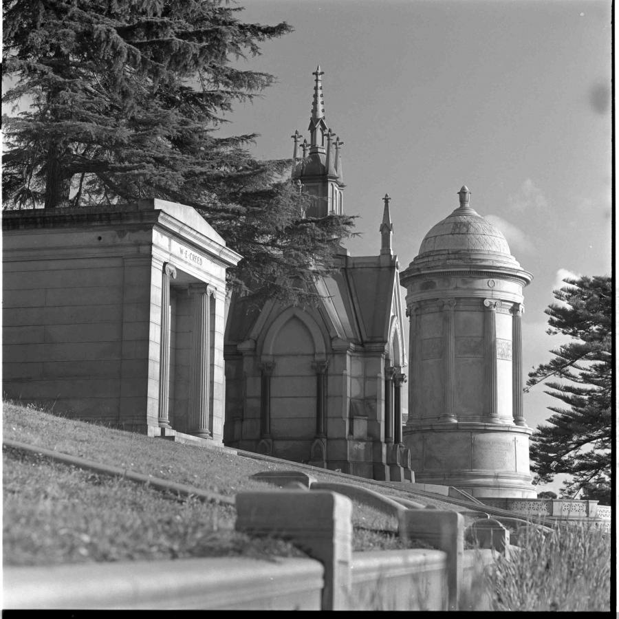

Hi,
recently I have had this kind of marks on some of my films.
I haven't yet tried to hunt out the reason but so far I am quite sure that mostly I have these when using Neopan 400 roll film developed in Pyrocat-HD.
Have tested with and without pre-wet. No difference.
My strongest suspects are either air bubbles or perhaps some remains of photo-flo or Tetenal Mirasol 2000 can cause these?
All films where I have seen these are developed with Pyrocat-HD 1:1:100 using partial standing method (first minute continuous agitation, then 3 inversions at each minute).
So before I waste precious film for systematic testing, I would like to hear if these marks look familiar to someone. It would save a lot of time and film.

Yes air bells, unmistakeable.
I add 3 drops of wetting agent to my Pyrocat HD and that totally eliminates the problem which is a hard water issue usually. I've posted images of visual test I did in the past with no lid on my tanks and without the wetting agent there was no way I could get rid of the problem.

I add about 3 drops per litre, it's important not to add too mush as that canl cause foaming.
A suggestion fill you dev tank with water add the spirals etc (no film) observe the air bells, then add just enough wetting agent to cut the surface tension, which releases the bubbles. I did that then also with some developer as I wanted to solve the problem once & for-all.
It's a problem that is more likely to happen with home brew devs with no sequestering/water softening agents, commercial devs usually have additives to help prevent thse problems. I'd never had a problem until I moved to Turkey but the water has a very jigh mineral content with a lot of calcium.

Looks to me like you could have used just a little more developer in the tank, and the problem would not have appeared. Bubbles like this form at the top of the fluid column and can get stuck to the spirals of the reel. If the reel were just a little more deeply submerged, the bubbles wouldn't stick there.

Same bubble symptoms -- dark spots on edge of image
Very timely thread!
I just experienced the bubble symptoms when I recently started using a larger 1-liter ss tank (2 120 reels + 1 35mm reel for "filler reel"). I shoot Acros and use Rodinal 1:100 stand development, in which I try to be gentle in my agitation. I rap the tank firmly on a wood board after each inversion set. I guess I was either too gentle, or didn't wrap it hard enough. I also filled the tank near to the top, which may not have left enough room for the agitation motion to be effective. Soooo many variables!! This is my first use of the larger tank; using a smaller tank had no problems.
I'll adjust my process, and try the wetting solution if necessary.
Thanks. Here's a shot of the bubbles on the right edge.

My problem with bubbles is now gone :smile:
By testing with only reel in the tank filled with water (Paterson 4, 500ml). I quickly noted that about 0.5ml of photoflo was enough for removing a lot of bubbles from the reel.
As the 0.5ml per 500ml feeled a bit too much (1:1000 when photoflo's normal usage on final rinse is 1:600), I did test with two 120 films and one liter with 0.5ml photoflo added (1:2000).
Both films came out without any traces of bubbles.
Have used since when developing Neopan 400 films. I haven't encountered any problems so this seems to be really good advice!
