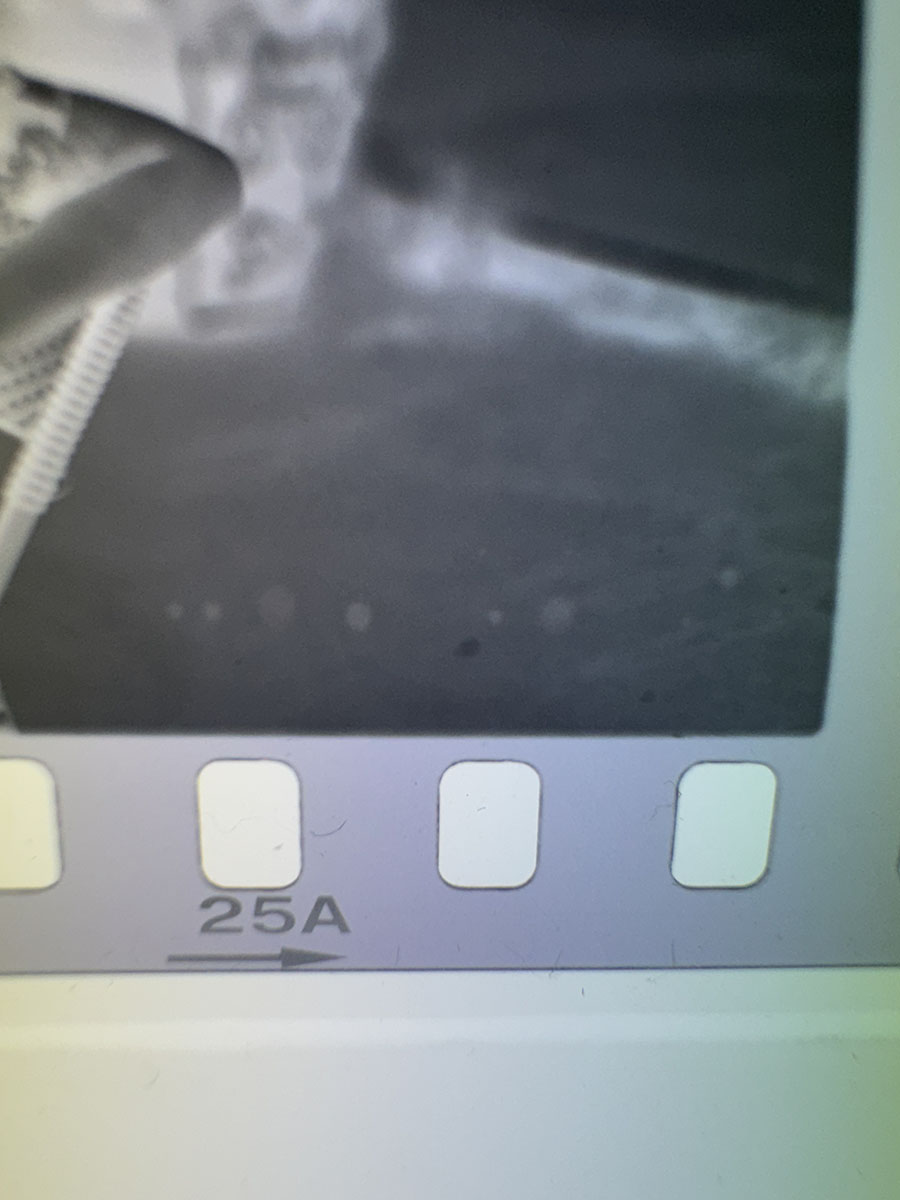

I am getting random spots on my negatives, as seen in the photos here.
Processing / Chemistry Details:
  • Plastic Paterson Tanks / Reels
  • Sprint Standard Developer > Sprint Block Stop Bath > Sprint Speed Fixer > Water Rinse > Sprint Archive Fixer Remover > Water Rinse > Photoflo > Hang Dry
  • All Chemicals mixed with distilled water, including developer, only the final rinse is done with unfiltered water.
  • Light to normal agitation, both inverse and shaking.
What is causing this? Any help is appreciated!

the film brand and type wasn't mentioned, as well as the storage conditions and age of it. None of the other information would lead to believe it was any of that.
Hm, I'd suggest doing that the other way round - use unfiltered (tap) water for all the rest, but demineralized water for the final rinse, where it really matters. You can also skip the fixer remover; it doesn't really serve a purpose on film. Doesn't hurt either, though.
Your process mentions two water rinses. Do you actually wash the negatives, or only give them a rinse? Not that this problem appears to be associated with underwashed negatives, but if you only rinse them briefly, you can expect problems to pop up later on (months, years).
How are these defects distributed across the film? Do they occur on only a part of the film, or all of it? Do the light and the dark spots ever appear apart from each other, or always together? Do the dark spots ever appear on unexposed areas of the negative?
I'd like to know this, too. And also whether the film was refrigerated/frozen and if so, how it was brought back to ambient temperature before loading it into the camera.

OP your processing regime suggests that whatever make of film this was, it was a b&w one and yet there is a distinct green cast on the left hand side as I view it. Is that just a scanning artefact that shouldn't be there?

My experience says dust on the lens would not result in well defined areas on the film.
Since the edges of the marks, while not sharply defined, are at least defined by shapes and edges, which makes me think some liquid hit the film when dry or nearly dry - either before development, or after when hanging to dry, or after dried.
Interesting that the spots are both light and dark - assuming the OP is sure neither were in the subject, which we can see only small areas of.

Those are air bells (bubbles). Be sure to pre-wet your film, and be sure to fill the tank all the way with developer. Pre-wet your film with water at the same temperature. Use inversion agitation, and tap the tank vigorously on the table after each round of agitation.

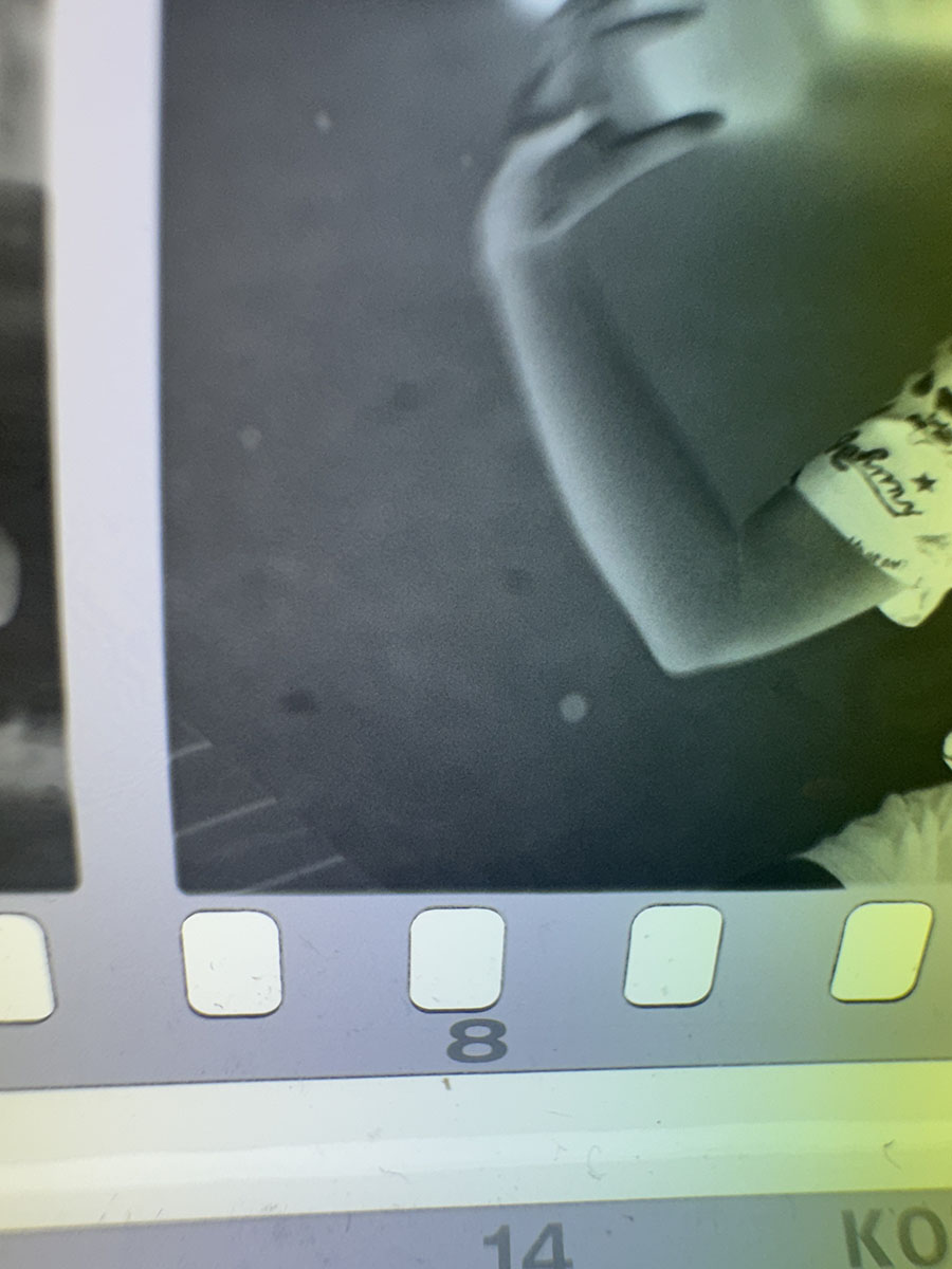

One can read Kodak on the second image. Could the spots be dust on the lens?
Yes and thanks about Kodak. On closer examination I can see the KO of Kodak. Still leaves the mystery of the green edge on the left hand side of the third neg, assuming that it is visible to the others I just wondered what this was - a colour that appears on the neg of just the third neg -some green cast caused by the scanner and not really on or in the neg at all?

idk doesn’t look solely like development issue given the variety of spots. Not enough info but i would start with the film then camera then processing. Get fresh film in a camera known to not have issues then see about the process

I don't think I've ever seen air bells causing both dark and light circles on negatives.
Dark circles are generally related to some sort of imaged flare, pinhole light leak, or localized emulsion contamination that results in increased sensitivity in those specific spots.

Looks like the typical result of using a cel phone camera to take photos of a negative in a location where the ambient light is uneven.

So far the OP is not replying. I've never used Sprint chemistry. I assume it's high grade stuff. I'm inclined to call it some sort of a film problem. Perhaps age, storage or a defective roll (from Kodak?). That doesn't seem likely.
Me neither. If it's just the lighter-colored ones in the frames, then I can go with tiny airbells, but even so, it's rare to see them cling this resiliently to the film. The denser spots cannot be explained this way. Although from the partial frames we're seeing, they can still be specular highlights in the background.
Just color from the light source used for the phone shot; ignore it, it's a red (green) herring.

I think the curious thing is the 'bubbles' only seem to appear on what I assume is the ground behind the person, and not on the person. So maybe a sunny day and something reflective in the paving/concrete/beach etc.? Although they could be two things, something reflecting and this is confusing the issue with a fault, so maybe the dark spots are reflections and the white spots dust?

@250swb for the dark spots in the negative I agree a plausible explanation would be specular highlights in the background. For the lighter spots, I'm not too sure. For dust on e.g. the rear element of a lens, they are awfully well-defined; even with a wide-angle lens (which this wasn't, by the looks of it) and a small aperture you'd expect them to show up more fuzzily. Dust on the film, on the other hand, would be much more sharply defined. So the light spots are a bit of a mystery to me, so far.
