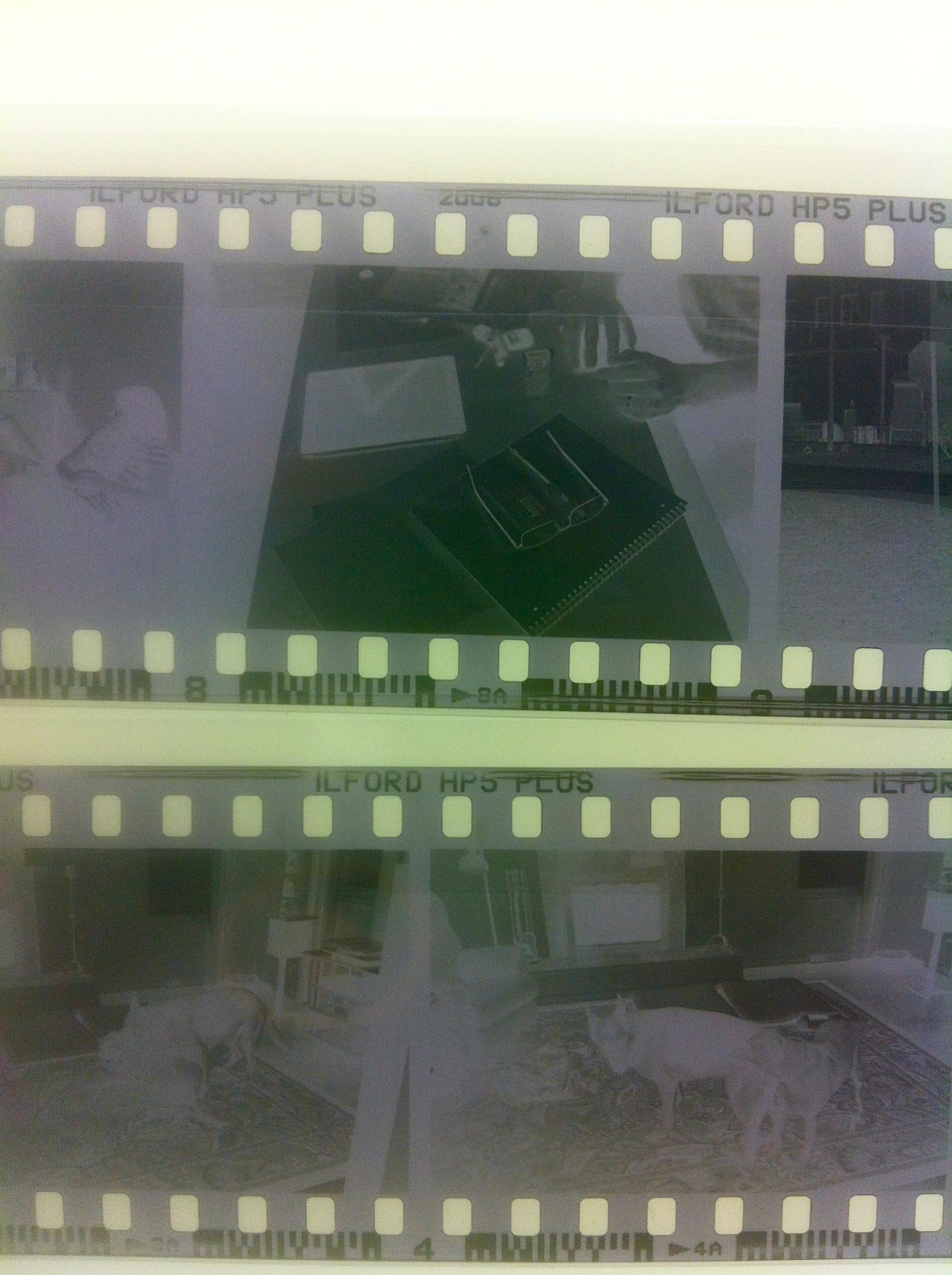

I've recently started getting dark edges on most negatives (see photo). I thought it might be a light leak in the camera, but then it happened again with a different camera. Any ideas where I might be mishandling things?
Thanks.

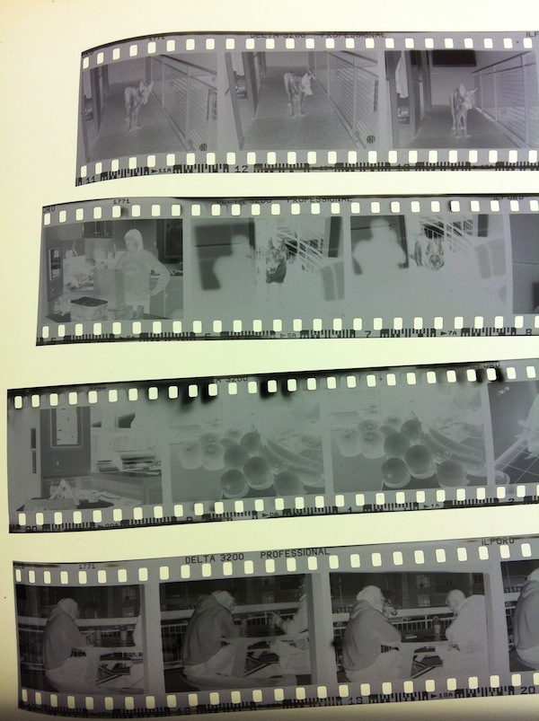

Not bulk loaded, thanks. All film types also. Using steel reels and processing myself. Looking back at recent negatives, it looks like this started maybe 10 rolls ago and seems to be getting worse. The earliest signs look more like drag marks of some kind. A sample is attached.

Indeed, it does seem like it could be caused by the reel interacting with the negative. I was about to dismiss it as a non-issue until I saw the latest negs on the light table. That sure looks like like light leaking _somewhere_ to me. Not sure it matters, but this latest example is on a roll of Delta 3200. Would that not be more susceptible to light leakage than the Tri-X?

On last negatives there are two things IMHO: some light leak AND marks from reels. I get those marks occasionally as well, using steel reels. Maybe it has something to do with film winded tightly on the reel?
Developer reaches the emulsion, fixer not, as the emulsion is already stuck to the reel. Re-fixing should get rid of those edge stripes, at least I have experienced this.
Black beyond the sprocket holes, on the last sample, looks something different to me.

part of it looks almost like a light leak where it is bleeding across the sprocket holes into the frame...

It looks like two different issues to me one of which has been addressed (friction fog). The other... where the fog is softer and shows repetition of the sprockets... that looks like a darkroom light leak to me. Maybe somone forgot to switch off the safelight... or maybe there's a bit of outside light leaking in. Those square patterns sure do look like the "leak" occurred while the film was already on the reels.
