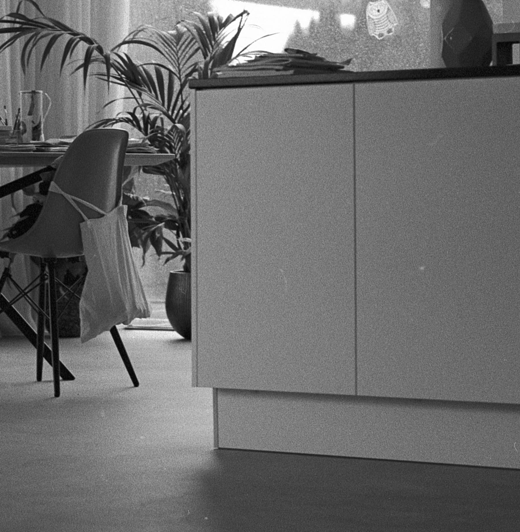

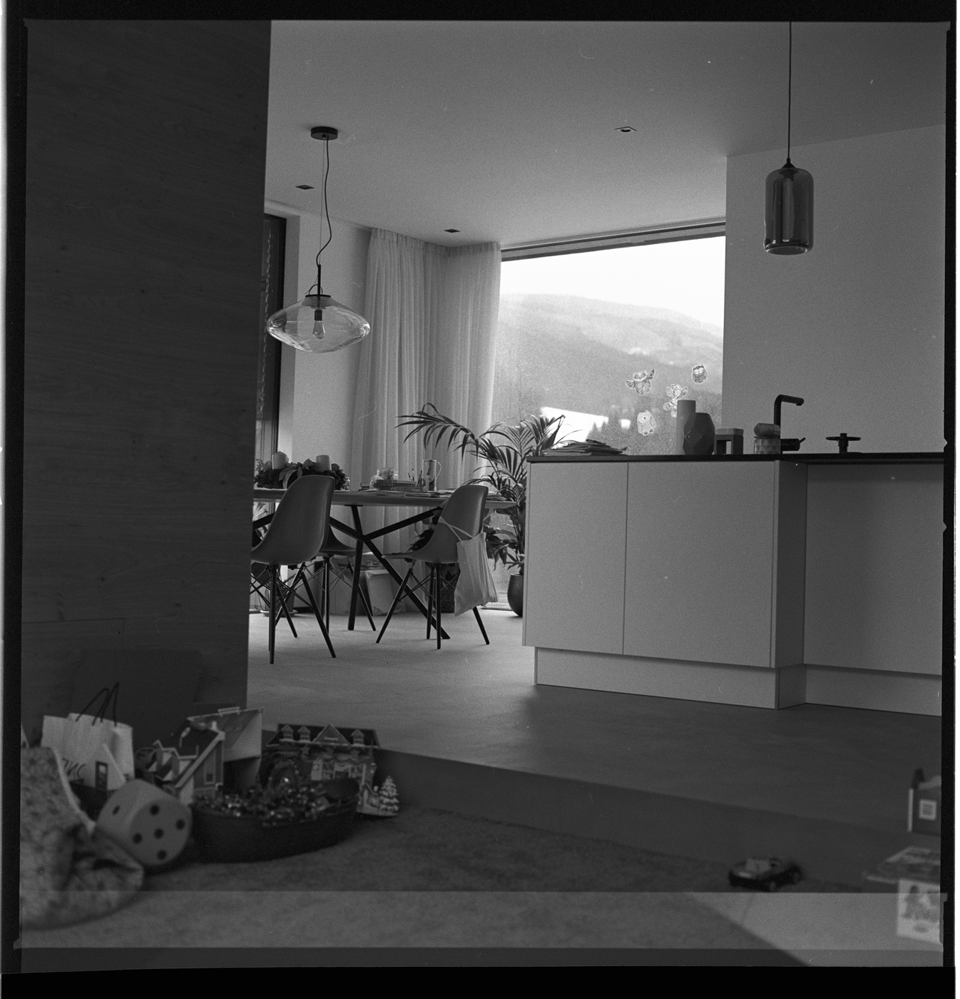

you see a sample .... a lot of grain - so my guess is that ,my development time is too long ?!
If I overdevelop my film the grain will be larger and more visible as I know correct?
sorry i did not mention that I use 1:1 D76
@mpierie
If you expose Tri-X at 200, then your negatives will be darker than those you exposed at 320.
yes the negatives are dearker but the final picture will be brighter - do you mean this ?
When I expose with filmspeed 200 and the film has 4000 - I overexpose the film a little bit.

Development wise that doesn't look too bad to me, as far as I can judge from the prints. It looks like you have the shadow detail you need and the high lights aren't blown out. The prints could do with a bit more contrast and could be printed a bit lighter, but that also is a matter of style and taste.

That doesn't seem excessively grainy for Tri-X to me, but I should disclaim that I first used Tri-X in 1975. The film has changed several times since then.
That said, as noted above, you developed for EI 200, near enough (9:45 vs. 9:30 in 1+1 on the MDC), your exposure at 320 ought to produce a slightly thin negative (2/3 stop under for the development).
Unless you have significant experience shooting and developing Tri-X, I'd recommend starting at box speed, both exposure and development. That speed was arrived at by Kodak via extensive testing to produce the best combination of final print detail (from shadows to highlights) and grain. Departing from that is best done intentionally, because your process or desired result differs from Kodak's, rather than because something you found on the Internet suggests someone else (who may meter differently, agitate differently, like a different negative, be printing optically where you're scanning or vice versa) preferred a different speed and process.

Thanks, but I'd rather see a photo of the negatives. An inverted scan doesn't say much.
+1
In addition, I am uncertain whether the OP might be referring to dark scans, rather than dark (as in dense) negatives.
