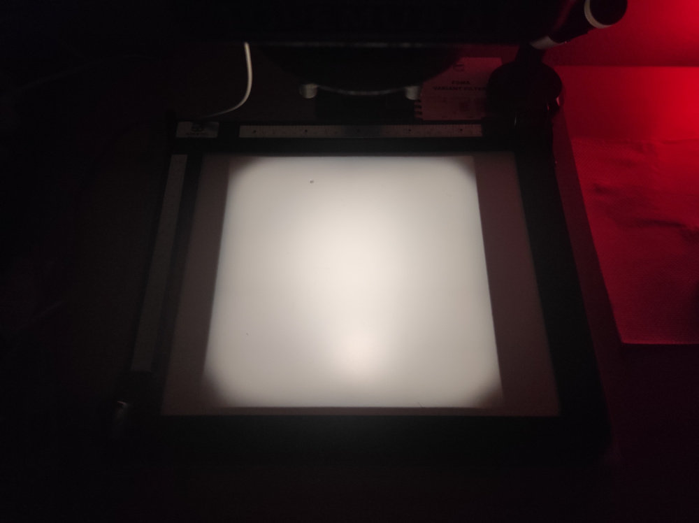

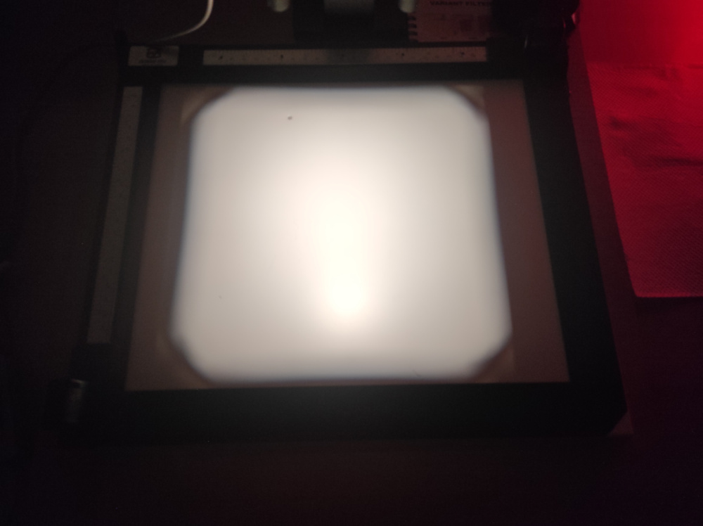

Here are two images of the light spot with a carrier (which has its own Newton's rings suppressing diffusor) and without it. It doesn't look like a lens vignetting but more like a sharp shadow. All internal condenser components are clean and in place. It's literally impossible to print 6x6 without cropping. Is it an inherent limitation of the enlarger or something is misaligned?

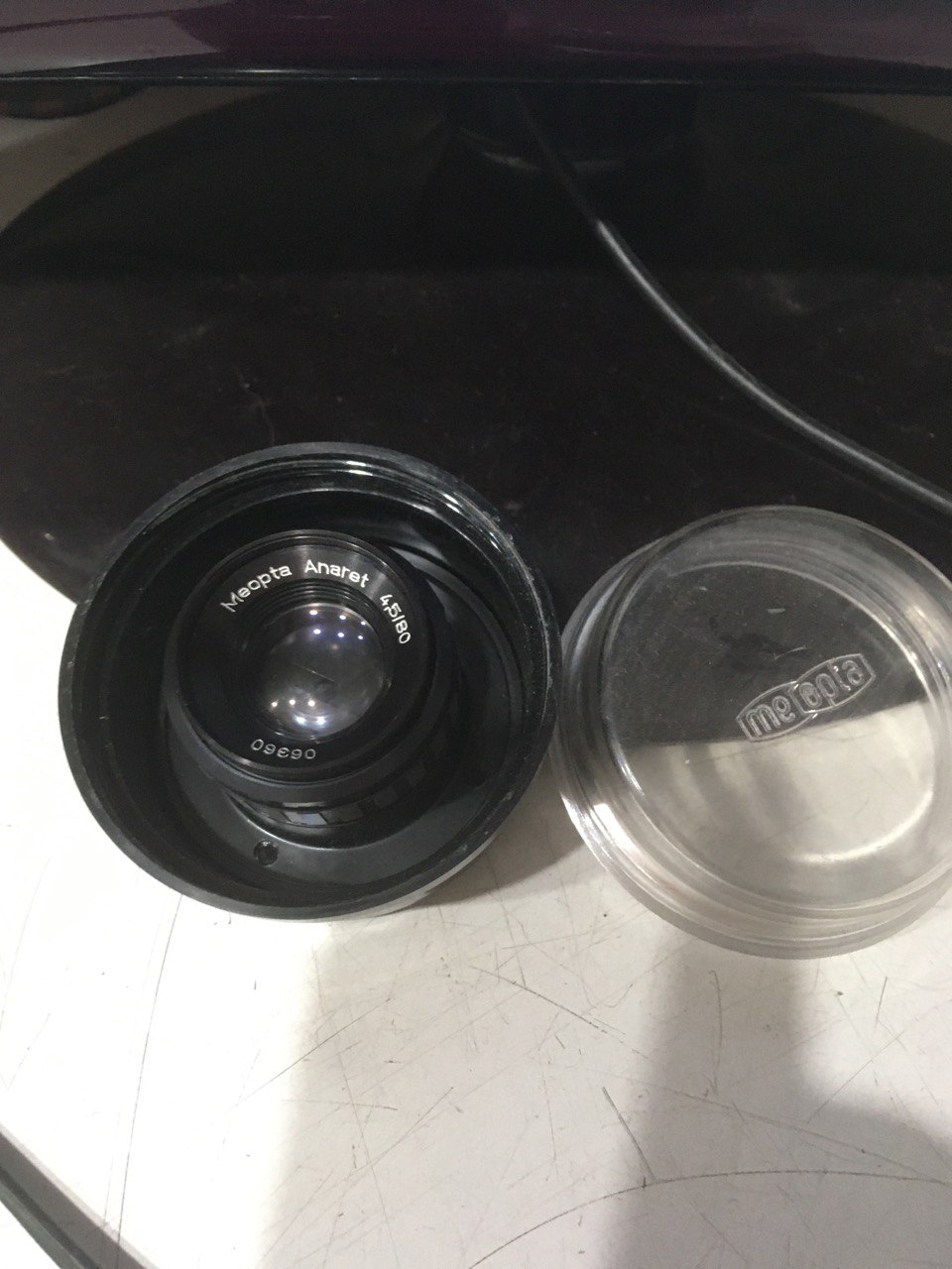

Indeed, the 50mm 2.8 is a brilliant lens, but for 35mm negatives. I use an 80mm Meopta Anaret for 6x6 in my Opemus 5 but a 75mm works as well.
The Anaret is usually pretty affordable and has very good performance imo. But any 75 or 80mm lens is fine.
