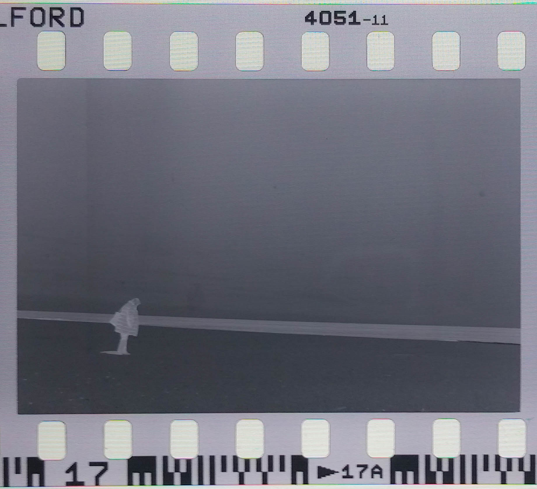

I'm hoping someone can identify the problem I have on about 1 frame for each roll I shoot. Doesn't matter what brand of film, hand-rolled or not. The left side of frame has an area darker that the rest of the frame and is usually toward the beginning of the roll. The camera is a Nikon FE. It looks like that portion of the frame is underexposed. I appreciate any thoughts on this.

It's not a light leak or a scanner issue because this area of the negative is less exposed. The problem is with the negative. It's usually around the second or third frame of the roll. Puzzling.

This is a weird one - just looks too linear to be a light leak or fogging. Does this effect extend into the sprocket areas of the film, or just within the frame? Can you take a quick phone pic of the film strip itself, held against a light?

I did my best with using a phone. You can see the area affected is only within the exposed frame.

It might be from an internal reflection in the mirror box, partially shaded by the frame mask at the film gate. With the film in the gate, that shadow would be on the right side of the gate, and the amount of frame it covers (roundly 15%) suggests the reflection is close to the shutter (behind/under the mirror), on the same side. You only see it occasionally, if this is the case, when there's something bright just out of frame that gets projected onto the reflecting object.
If you hold the shutter open in B you might be able to spot something on the right side of the mirror box that's glossy where it should be matte or flocked.

Nothing looks shiny or out of the ordinary. Thanks for the suggestion. This is probably one of those problems that's going to be elusive to a repair person.

Thanks for showing the whole negative. I was going to suggest some issue with the door or light trap on your bulk loader, but does not seem to be the case. This is very odd.

It's puzzling; the overexposure being confined to the image area suggests it is coming in from the front while the film is in the gate. But it's also hard to understand how to get such a sharp edge from a light leak. The extra exposure seems strongest vertically about where the person is in the beach picture, with a sharp edge at the left and tapering off to the right. Also that's frame 17, so perhaps not a beginning of roll problem.
I'd suggest: with no film in the camera, hold the shutter open on B, inspect the mirror box (I know you did this) - there should be flocking on the back of the mirror and dark ridged panels firmly in place at bottom and sides. Look at the shutter while advancing to see if anything odd is happening with the blades.
You could try loading the camera, winding it up to exposure 1, take it out into sunlight and hold it at all angles to the sun, then take one exposure with the sun just out of frame. Then take it back into the darkroom and cut off and develop only that part of the film. That might help isolate the location of the problem.

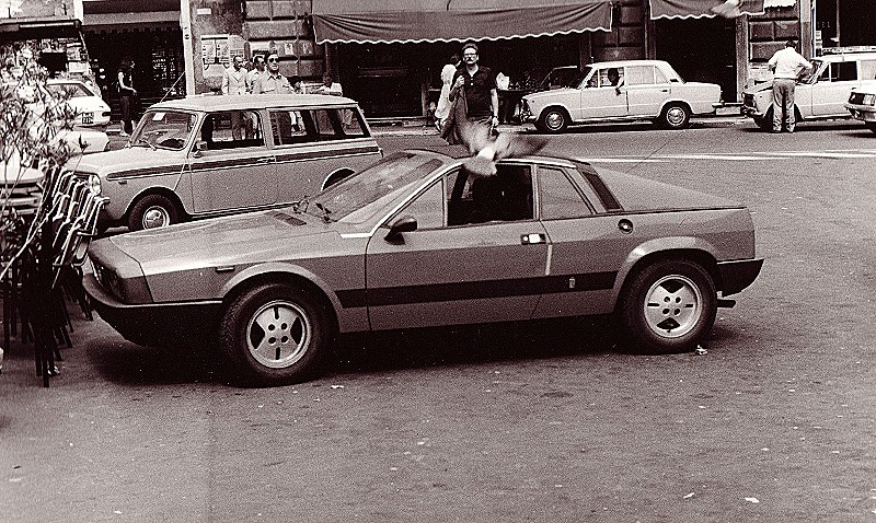

I have this picture in my archives. I took the picture in Italy in 1979 (I was and still am an Italian car fanatic).
Years later I actually purchased a Lancia like the one in the picture. I went back and re-printed this negative from 1979. The mark is similar to what the OP shows. It only is in the image forming area of the negative.
Curiously, in tens of thousands of prior or subsequent exposures, I have never encountered this. I always considered it a film manufacturing defect.

It's a shutter curtain issue. The camera needs a CLA and possibly new shutter curtains. I work with larger FP shutters and they overlap, slide over each other. once perishing they can get sticky, any issue is worse with 35mm cameras.

Would've been my first guess too, but the FE has a vertical-travel shutter.

My photograph in post #22 was also taken with a vertical focal plane shutter.
