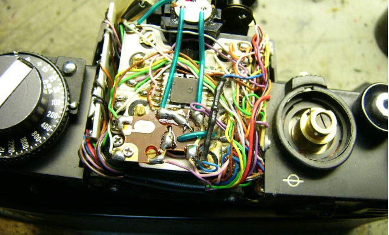

Having started another thread in which I expressed some frustration with Don Goldberg, DAG Camera Repair, I feel I need to put the end here. It was a frustrating situation all around, but Don is being nice, lord knows I'm trying to be too, let's go into the holiday season on good terms all around.
The original thread is here: https://www.photrio.com/forum/threads/how-long-does-dag-take-these-days.195593/
End result -- I heard from Don today -- he fixed the small mechanical thing I wanted fixed, but says the auto shutter speeds are off and he spent "many hours" trying to get it right and just can't. He sent me a picture (see below) of the wiring that Leitz put into those things, which resembles a rat's nest, I'm really disappointed Leitz would make something so sloppy but Don said that Leitz tried to backfill spot metering into a Minolta design that didn't have it and this was the result.
Don says this experience only confirmed, to him, his decision not to do R3s any more...just not worth it.
So he's sending it back and I'm fine with that. The only criticism I can find is I wish he'd sent me a note to update me more often -- something along the lines of "this damn thing of yours won't let itself be fixed" so I'd know.
It's as if they rushed an early prototype into full production. Workmanship looks about as good as they could make it, considering that the hot mess of a design than they had to work with.
Well it was a huge jump in design from the Leicaflex SL2 and was done in cooperation w Minolta & built in Portugal.

The surface mount circuit boards with the wiring, and bits and pieces are soldered by hand directly to the board. Besides the board on top you can see a CB on each side of the prism. One controls manual SS and the other one controls the AE. The CBs flex due to weather and the solder joints become brittle so after decades the connection breaks. Take it all apart, figure out the problem, cram it all back together and another joint breaks. So now you start over, you get it working, send it back to the happy owner and 2 months later another joint break and you get back a warranty repair. Surface mount circuit boards was cutting edge technology up until the '90's or so when some smart engineer figure out to design all the chips directly onto the board (no soldering). I can remember buying blank boards at Radio Shack, etching the electrical paths onto the board, and then soldering in the components. BTW there are other cameras (no longer remember which ones) that repairman won't touch because the insides look just like the R3.
yeah, but you know after all the hubbub i got out my SL2 and put film in it and it is such a joy to shoot I kick myself for not using it more.
But of course the R3 was great to use when I got it. Such is life.

My main camera repairman now refuses to work on any German designed SLRs because the convoluted over engineering takes too much time to repair. Friends who worked at Leitz, and then Leica Camera, would comment as well on the rough work often seen inside cameras. I don’t attempt camera repair, so just repeating what I was told. The secret behind Nikon shutters...ball bearings. Leica only used them once, briefly, on Leica C during WWII.

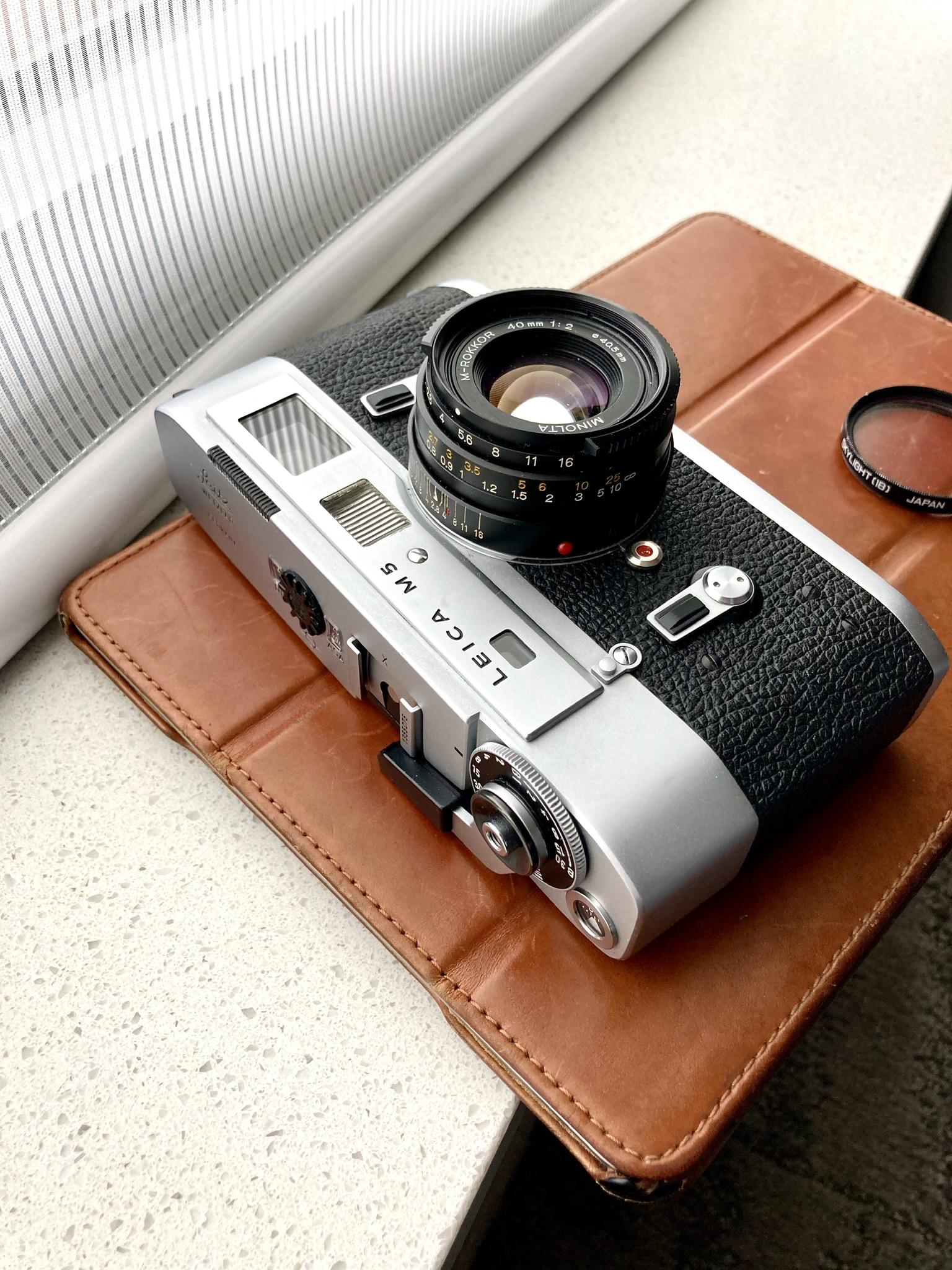

Don had my M5 from late Nov 2020 to Aug 2021. He failed to respond to 3 email requests for update. I was in Madison, WI for the summer and contacted him by phone. He had the camera CLA with new BAT compartment in 2 days. Don was nice to visit with, implied the camera was in backlog too long and during the in person pickup mentioned his purchase of ELCAN M5 parts as reason for part of the delay.
I was relieved to get my camera back repaired. I found him in person to be credible and honest.

Don had my M5 from late Nov 2020 to Aug 2021. He failed to respond to 3 email requests for update. I was in Madison, WI for the summer and contacted him by phone. He had the camera CLA with new BAT compartment in 2 days, was nice to visit with, implied the camera was in backlog too long and during the in person pickup mentioned his purchase of Leica ELCAN M5 parts as a reason for part of the delay.
What a lovely camera!
Jul 1, 2006
875
Oklahoma, US
Yes, the M5 is nice looking. It lacks a bit of the hand feel of the traditional M3 shape but it’s far from too large. Photographers use a camera to expose film and the M5 viewfinder and shutter speed dial are superior to the M3, M2, M4, etc.
