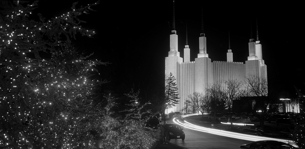

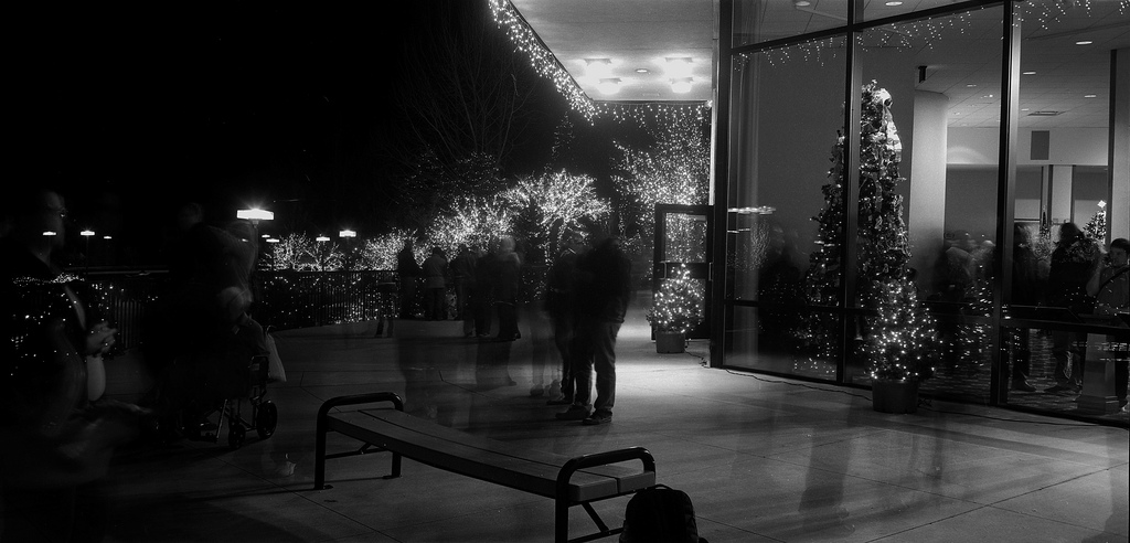

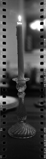

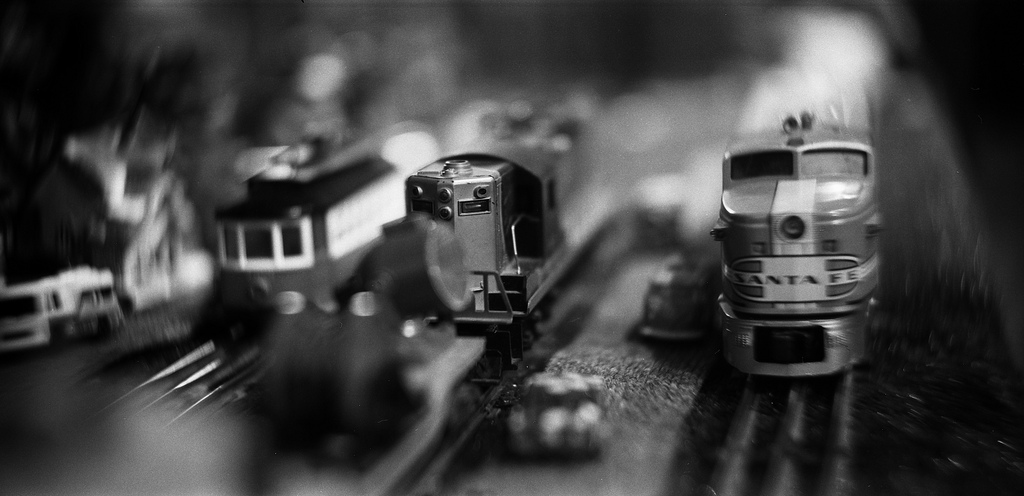

Here are three images from my first roll of film from the back. No scratches, and the film seems to be held plenty flat. The only issue I ran into is that the last image on the roll, was shot off the film, and there was extra film toward the front of the roll. I'm not sure how this can happen, as the look-through-the window advance should be foolproof. This can't be an issue with the back, it's too simple to not work... Perhaps the film was mis-taped to the backing in production. (Roll #2 will tell more on this)
The first image is with a Petzval on a Pacemaker Speed, and the rest are on an Anniversary Speed with a 101mm Ektar f4.5, the film is Delta 400 in D-76
