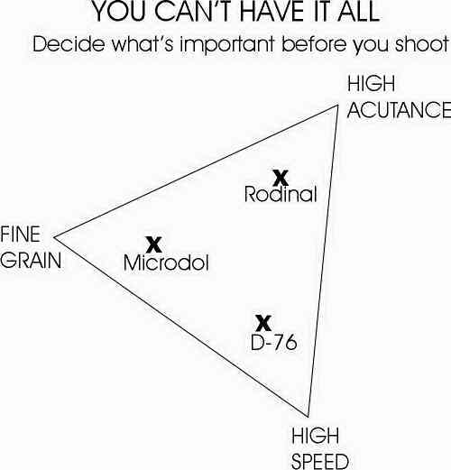

D-23 has a lot of Metol because it lacks an accelerator, like borax, which D76 uses. So by reducing the amount of developing agent, Metol, they are compensating by adding boxax, an accelerator. How much this moves the results in the Speed/Acutance/Grain triangle? I have no idea.
I like the chart.
