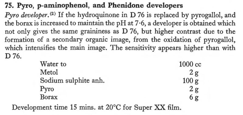

Here is an interesting D-76 "variant" I had never seen before, found in Glafkides' Photographic Chemistry, Vol 1, p 76. Haven't ever tried it.
Pixophrenic
Mar 30, 2017
368
Canada
See post #11 in the discussion about this developer that was first posted by Ian Grant in the Resource section in 2013. Oddly, this developer a.k.a. Smethurst developer, is mentioned in several books throughout the 20th century, but none of the authors apparently tried it.
