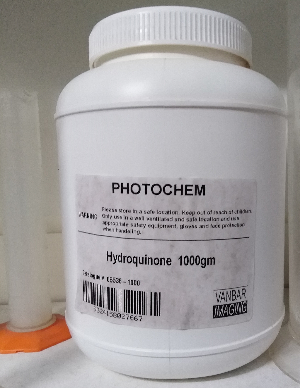

I purchase Hydroquinone in 1kg lots from Vanbar, this is about the cheapest way to purchase it. I fully realise that this means you are purchasing in some cases, years of chemistry, but it doesn't go off. My oldest stuff is a job lot I bought in 1992, all of it works beautifully.
Vanbar will realistically make up any quantity of chemistry that you wish for, they are overall very good for the darkroom worker. Some chemistry can be purchased elsewhere, pool suppliers, hardware stores and even local pharmacies have some stuff cheaper than anywhere else. Ascorbic acid comes to mind with the pharmacist purchases.
