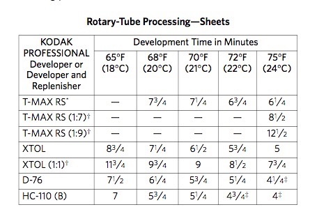

D-76 1:1dilution +Jobo 3010 + CPP2 Development time for T-Max 100

Hi, Kodak only gives Development times for Rotary-Tube Processing — Sheets at Full Strength.
Can you tell me the Development Time for D-76 1:1 dilution ?
Thanks
Luis

I think to develop 4 sheets ( 4x5 ) using D-76 250cc + Water 250cc.
