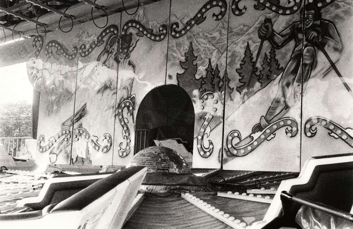

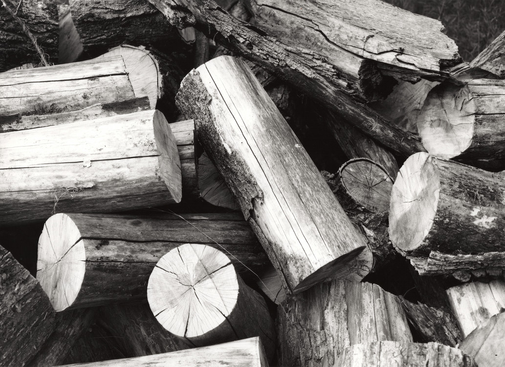

A couple of my own examples processed as described. Scans of prints. The first is 9x12 Fomapan 100 the second is Double-X 35mm:

Those examples are interesting, particularly the logs. What was the luminance range?
I don't recall exactly. It was late afternoon and the sun was striking the scene low over my left shoulder. From the very dark shadows in the crevices to the brightest illuminated log faces was probably something like 9-10 stops. Printing this does require burning the bright log surfaces, but that's where the compensation effect of D-23 comes into play as it preserved detail there.
