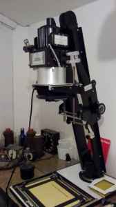

I attached an image of Omega D-2 enlarger. I know it is a small low res image but I was hoping someone with a little experience with these enlargers would be able to tell me if that looks like a variable condenser model or not. It appears to be so, but I am not 100% sure. Thanks.
Yes, see the chrome front plate on the variable condenser drawer on the lamphouse.
This is directly above the round chromish regular condenser housing.
That hinged chrome flap is a drawer where you can position the variable condenser.
