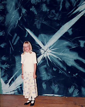

Don't use any soap. You want to avoid making the cloth alkaline and soap may do that. If anything, I might add a bit of white vinegar to the water to acidify it just in case.
I haven't used canvas but have done 9'x9' cyanotypes on muslin successfully. I sensitize by dunking the entire prewashed and dried fabric in a bucket filled with cyanotype sensitizer, then wring it out and hang to dry in a darkened room over some newspaper with a plastic dropcloth underneath.
I've attached an example photogram.
