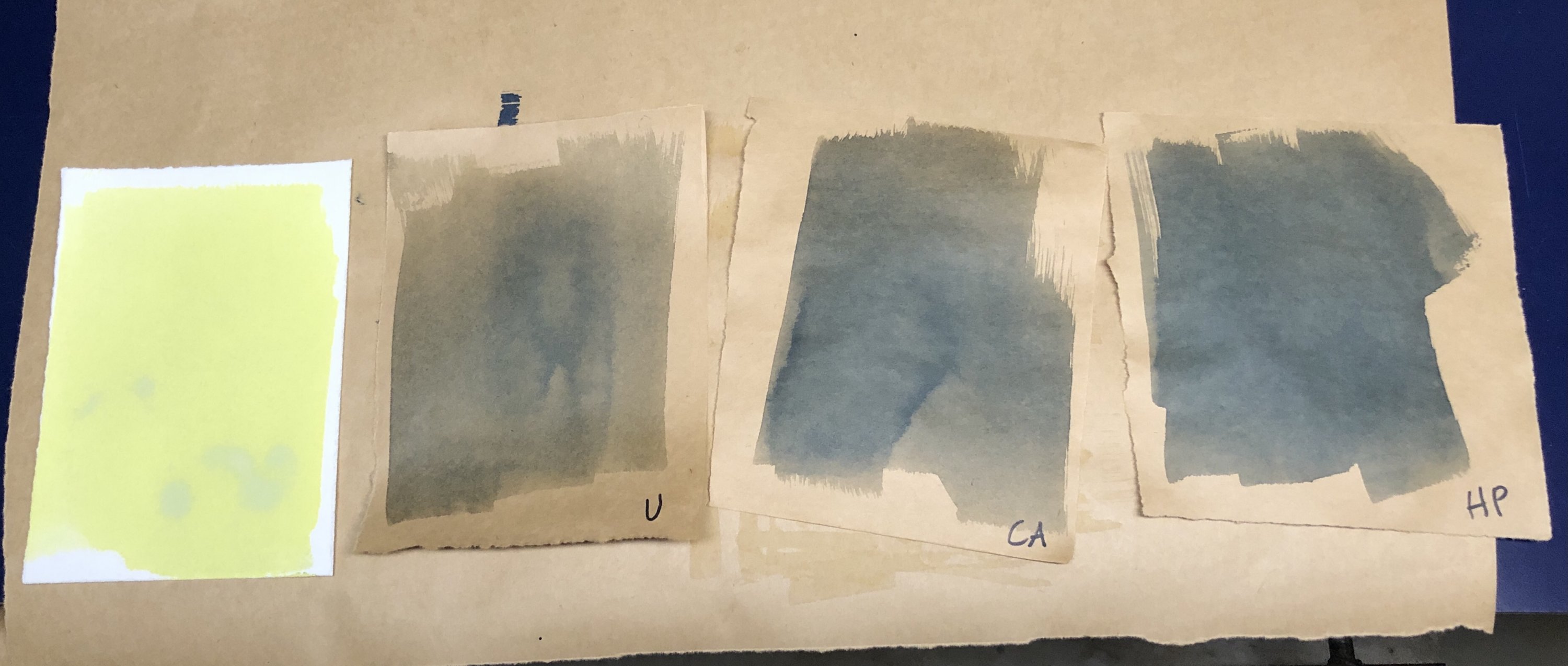

Just a followup...I just coated 4 pieces of paper with cyanotype sensitizer. See the photo. The one on the left is watercolor paper. Moving to right the next one was plain untreated craft paper, then craft paper that I'd soaked in citric acid, and finally, on the right, one that I'd soaked in hydrogen peroxide. I let them dry in the dark and then took this photo. I guess I won't be using the craft paper for this project. I have lots of watercolor paper and Stonehenge so I'll stick with those.
Thanks.

Well, that seems pretty definitive! Thanks for reporting back.
I think you've got the right idea... sometimes in alt processes it is just not worth fighting with the paper!
Stonehenge is a good choice, the warm variety is one of my favorites for both cyanotype and salted-paper.
Do you know that Stonehenge comes in a variety of colors, including "kraft", see https://www.acuitypapers.com/Stonehenge-Paper-p/119-0060.htm.
I have not tried any color but white, warm and cream for cyanotype. Those all work.
Maybe a colored Stonehenge would allow you to achieve your initial vision.
