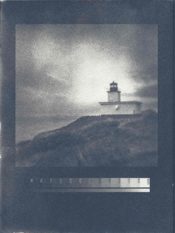

As it so happens, I have recently (in the past month) begun, after a hiatus of about 12 years, to make cyanotypes again.
Here is a recent example:
This image was made by using a digital camera to photograph the ground glass of a camera obscura. An inkjet negative was made from the digital file and printed using the traditional "A+B" cyanotype recipe on Arches Platine. It was developed with 25% vinegar. Finally the print was toned with tannic acid and ammonia.
Cape d'Or Light
