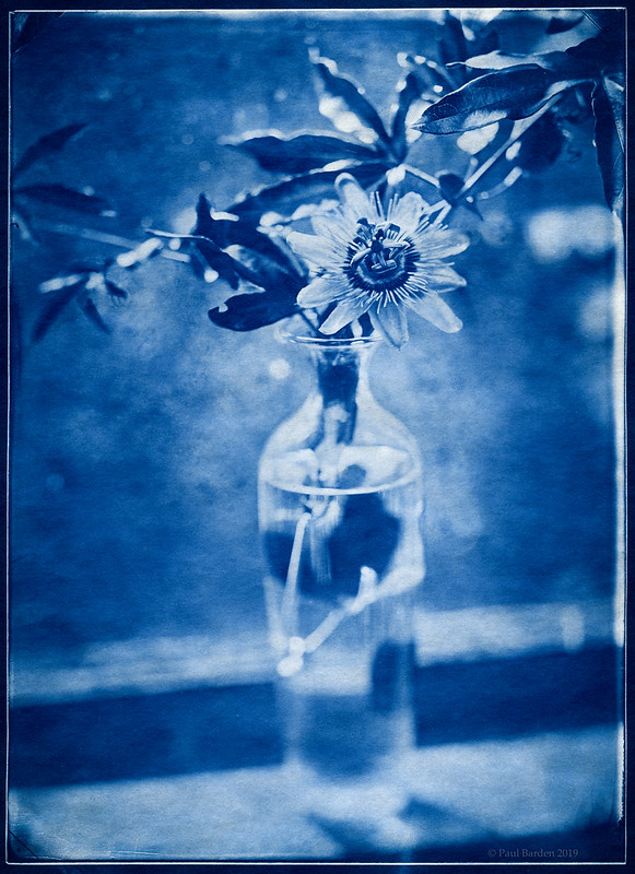

I've given up on all of the pricey watercolor papers for use with cyanotype - they all perform poorly in one way or another, it seems. Its probably the buffering agents they use.
I got the best results I've ever had printing on Canson's Marker Pro Layout Pad paper. Its an 18lb hot press paper - very light weight but it doesn't absorb excess sensitizer and renders fine detail like no other paper I've used. Because of its light weight, it does require careful handling when wet, but it gives superior results with the Ware formula Cyanotype. Here's an example:
