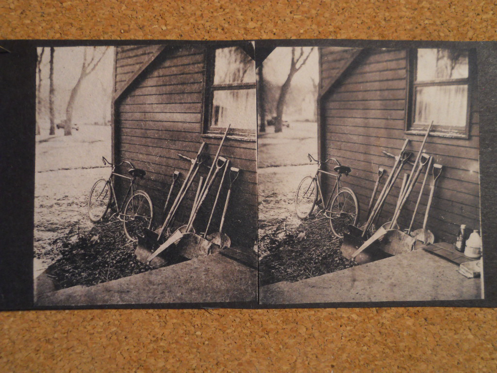

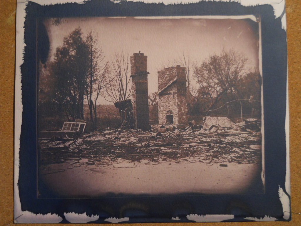

Here are examples of my toned Cyanotype Prints.

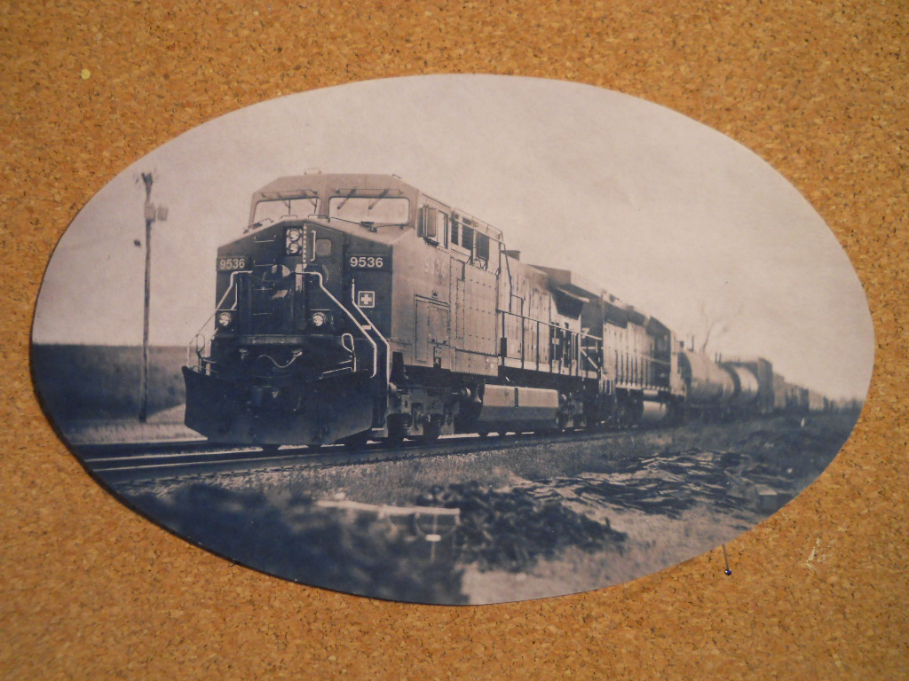

Very nice kevin - can you post your recipe and toning technique? Here is one of mine from a 6X6 neg...

Thanks. My way of toning is very basic. I bleach with sodium carbonate or borax, the borax is less touchy as the carbonate will bleach out the mid tones if left to long. The amount of either is very little,about 1/4 tea spoon to a pint of water. The time for bleaching seems to make a difference in tonality, a short bleach will allow the shadow areas to be more blue while the mid tones are brownish, longer wil make a more over all brown. Ammonia added to water will also work as a bleach. Experiance will tell you what will work for you or not depending on what effect you are looking for. The toner is green tea, some brands have small tea bags with about 1gm in them and others have 2gm. I use two 2gm or four 1gm bags and let them soak in the water for a bout five min. It can be used hot or warm, cold will take longer to tone the print. I usualy get a good color in about 4 or 5 min. with hot toner and as it cools down it takes about 10 - 20 min. It is very flexable and the results are not always exactly the same. I think it's fine. Be aware that some things do not always work the same for everyone.

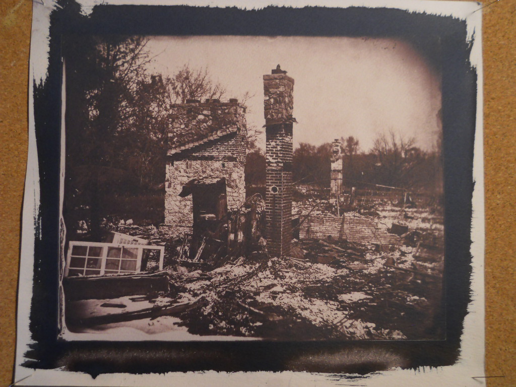

Here is one I did a while back - came out to light and I almost threw it in the trash but went ahead and dried it. Still almost threw it away after drying but tried drawing in the areas that were to light, with a lead pencil. Ended up matting and framing it and one $200 2nd place in our local art museum exhibit.
From 4X5 neg
