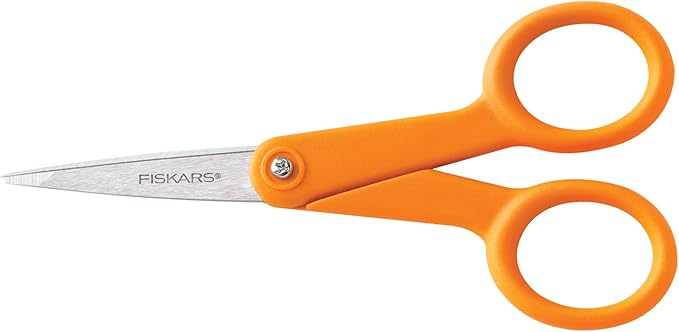

For 120, a good pair of scissors (I use 5" embroidery scissors), working over a lightbox, works just fine. And the lightbox doesn't have to be anything fancy.

I cut my negatives from the hanging strip. I hang with the first frame down, so they cut in order (one less complexity in life...). I find if I have a light background I can see the frame gap well enough to use good sharp scissors (5"+ blades as I find it easier to line up longer blades and make one cut) for 120, and the odd 35mm I still use. I don't cut my 4x10 from 8x10 sheets - easier to file and double index the whole sheet.
Practice helps. After a while I just didn't think about it.
Exactly the scissors I use. Never a problem unless I'm being careless. I've even done slides with them judging by eye.

Fabric shears. Only I use the bigger ones, so I can cut it all the way through in one cut. They tend to cut better than ordinary scissors or kitchen shears. Tough, don't use the same ones that you cut fabric with. It'll dull them. It's easy. It doesn't require special tools. It works without scratching. I can't imagine doing it any other way unless you cut thousands a day for a living. Then, you might need specialized equipment.
