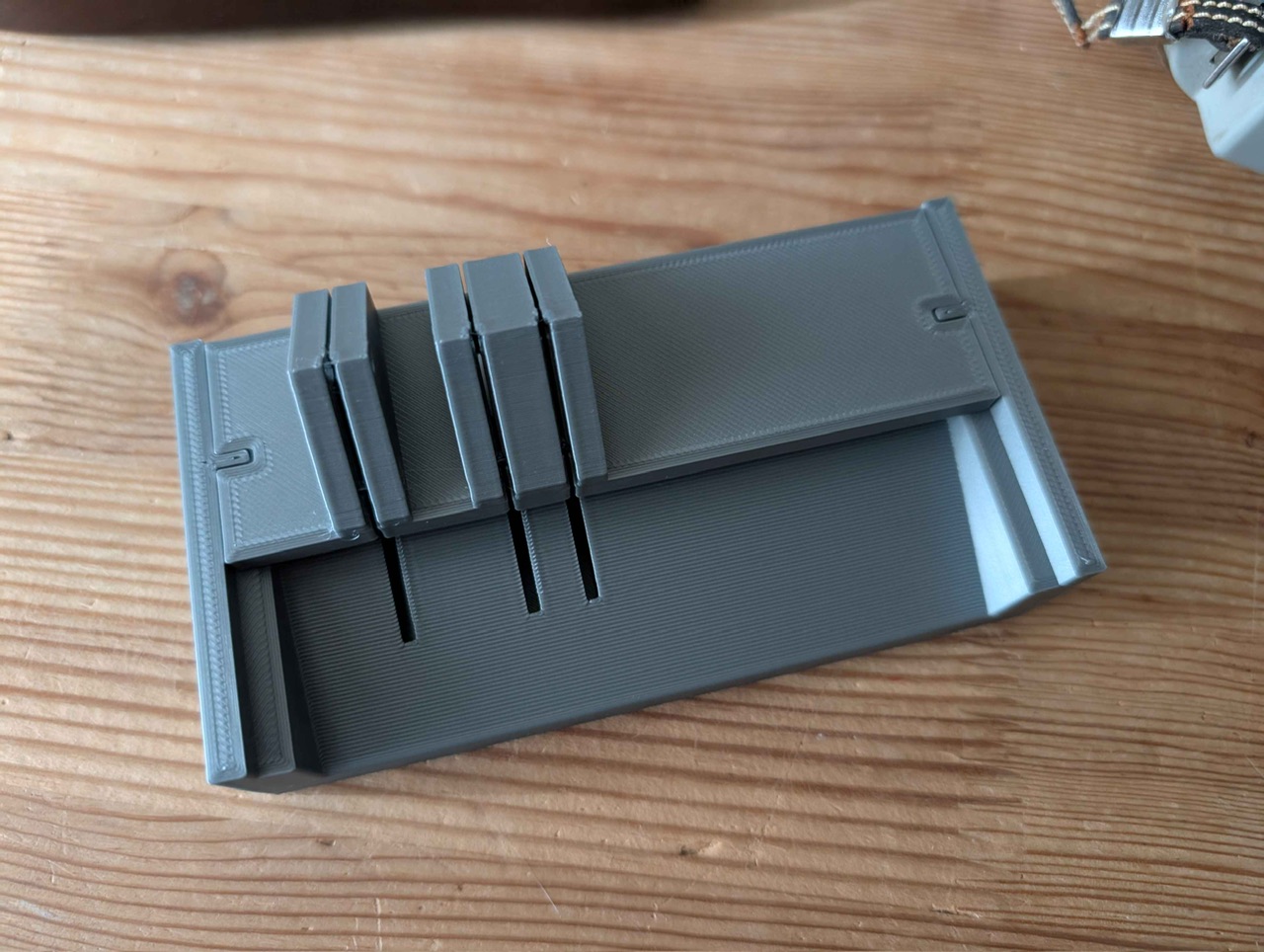

Slitter is printed, hopefully this and the film will come sometime this week.
Can cut 89mm (122), 70mm, 61mm (120/220), 35mn, 16mn, 9mm (minox), and 44mm (infuriatingly close to 127)
