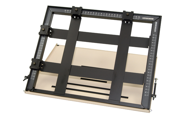

The easel I use looks pretty much like this:
attachment.php
I can adjust to 5x7 with an 8x10 in place, but the problem is the area outside that will get exposed.
I assume if I don't care about wasting paper, I can just cut off the outside parts later.
