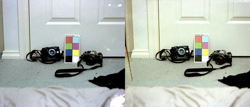

I decided to try it.
Short of it: Film I used was so crappy, fogged and dense, it wasn't a great test, but it demonstrates Copper Sulphate Bleach works 'just fine'.
CuSO4 Bleach Recipe: 100g/L CuSO4, 100g/L Table Salt (sea salt, anti-caking agent, I had no straight NaCl, didn't seem to matter as far as I can tell). Also I didn't filter or decant it, I forgot, didn't seem to matter either.
Film: Unknown/unbranded 12-exp 400 ISO old and expired (50 cents a roll!) and fogged.
Exposure: EI 50.
Process:: Flexicolor C-41 (2min 45sec, was intending a "N-2" development), thorough rinse, weak sulphite bath/clear (had no metabisulphite left), thorough rinse, bleach (one frame was in flexicolor bleach, the other CuSO4 bleach), thorough rinse, weak sulphite bath/clear, thorough rinse, fix, thorough rinse, stabiliser.
Bleach time was 17 min as I walked away and forgot about it.
Results upon inspection after bleaching: This stage demonstrated CuSO4 bleach works, back of the film turned green/blue just like the flexicolor frame, and allowed me to see the image on the back of the frame, just like the flexicolor frame.
Results after fix and stabiliser: Dense, can't see any retained silver, bleaching looks complete.
Results after scanning: Dense, both reach same basically same max density, retained silver negative would increase this density well beyond the end of my scanner. Colour seems fine and correctable, though both hard to correct due to density, it's beyond the normal "maximum" density/level setting and would be clipped out on auto.
Red, Green and Blue densities all seem to have the same general separation as flexicolor bleached negatives. Need to test with fresh film and normal process to see where the mid tone levels for each red, green and blue densities lay in relation to one anotehr compared to a flexicolor bleached negative.
CuSO4 bleached negative exhibits broader density range for individual Red, Green and Blue densities, but is a completely different image (not the best test I know, but this is Test #1).
Image grain is increased for this film but not significantly over normal (believe it not - its rather quite crap), but I am putting that down to the high density, probably scanner noise because of that density too (it's a negative, and it's a V500, meaning crap sensor (and crap lens) and high density = right in the shadows on the sensor with the worst part of the SNR).
Film Density: Both are about the same, and are two comletely different images. The maximum density on my V500 is quote at 3.4, so assumedly it'd be near that figure, but I know thats crap, it's under 3, I 'm sure it's around 2.8, maybe even 2.6.
Conclusions: CuSO4 bleach works "just fine" and is worth more investigation on a more thorough test, and I can't comment on colour balance until I do so.
Another test should be done on fresh film, normal exposure, normal development, same images/scene/subject, and add in my poor-man's colour checker with same exposure for a comparison of flexicolor bleach vs CuSO4 bleach vs bleach bypass.
Image:

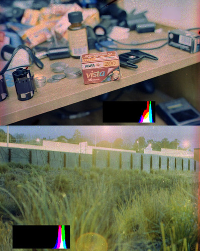

Okay the density problems.. initially I suspected the film.. but then I had some Agfa Vista 200 only expired in 2009... didnt do a sulphite bath... nope not sulphite clearing bath thats causing problems.
Mixed fresh fix.. not fixer, then I suspected contaminated developer... tipped it out mixed up a fresh batch.. nope no problem there.
There I got a bit more suspicious and thought that the CuSO4 bleach may be indeed absolutely terrible and my current mixed up flexicolor bleach in bad shape.. mixed that up from scratch too.... nope!
Only variable left was the film after all.
The Agfa Vista 200 (which I got from the same place as the unknown 400 for 50 cents/roll) expired in 2009... basically 'fresh'.. its in terrible condition for a '09 film. Must have been stored in a baker's oven.
Anyway, just used my last roll of Ektacolor Pro 160 (nice film, but real PITA to load on reels strangely, very difficult to thread, seems to be slightly shorter than normal by a hair, and is stubborn/grips the reel a lot) for the test which I know is good... came out brilliantly... not dry yet though.
Will post one from of that same subject/exposure (flash bounce) from the flexicolor bleach and one from the CuSO4 bleach once dry or after I wake up at least.

Flexicolor on the left, CuSO4 bleach on the right.
Density still appears high, and dMax - dMinx needs to be broader/larger (I mixed my own Flexicolor C-41 starter from some old notes and I think I've only put in 1/3rd of the Bromide needed which would explain a lot, but otherwise everything done to these two frames is identical down to the scanning and correcting, only variable is the bleach), but significantly better than the other films I used.
Identical processing apart from bleach.
Scan levels were reset and widened to ensure no clipping, same settings for both. No correction during scan at all apart from inversion (so frames were blue).
Both images put in Photoshop and merged to one layer, black point set to the 'black' box on the card' and white to the white box on the card on the Flexicolor image (left) just to see a general colour correct image with corrections applied to both frames identically, to see difference between the two bleaches in terms of colour.
This test also did not use clearing baths as I was still keeping variables to the minimum for other troubleshooting.
So this is what you might expect from the difference in colour if printing it exactly the same as regular C-41 processed film, or scanned with same settings/colour corrections (eg: A profile set up for x film)
CuSO4 vs Flexicolor Bleach Test #2 by athiril, on Flickr

Used the unknown 400 film again. After pulling my hair out and mixing up all chemicals AGAIN. I used a stop bath straight after development made of apple cider vinegar found in the cupboard at 1+2 (I didn't have anything else.. need some more supplies).
Results are significantly better, dMin is reasonable looking at the histogram but could definately be better, though the image is similar to above.. ceiling bounce flash.. not much of a contrast range in the scene, probably 3 stops at best, so it could probably be lower with a higher range? Something to test. That and it is the crappy unknown brand 400 ISO film, that also I suspect is quite old given where I got it from the place and the date of the other films being sold along with it.
Weird that I never had this problem before, it might be something to do with my water at my new house being pH ~8.5.
Another bleach test will come next week.
edit: Using a blank frame from a lab developed Reala negative, I compared it to blank frames of the cheap 400 ISO negative processed earlier, and then also the cheap 400 ISO negative processed with a stop bath after.
The cheap 400 ISO negative (no stop) blank frame from what I can work out is 0.616 density over the Reala blank frame.
The cheap 400 ISO negative (with stop bath) blank frame is 0.39 density over the Reala blank frame.
And then also compared to one of my Rodinal rehal neg (Pro 400H) which was 0.195 density over the Reala blank frame.
