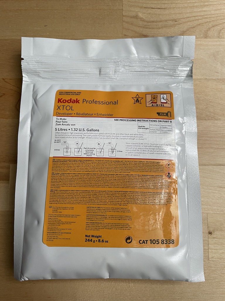

I would appreciate a pic of the correct packaging as further assurance that I get the most current stuff when I order.

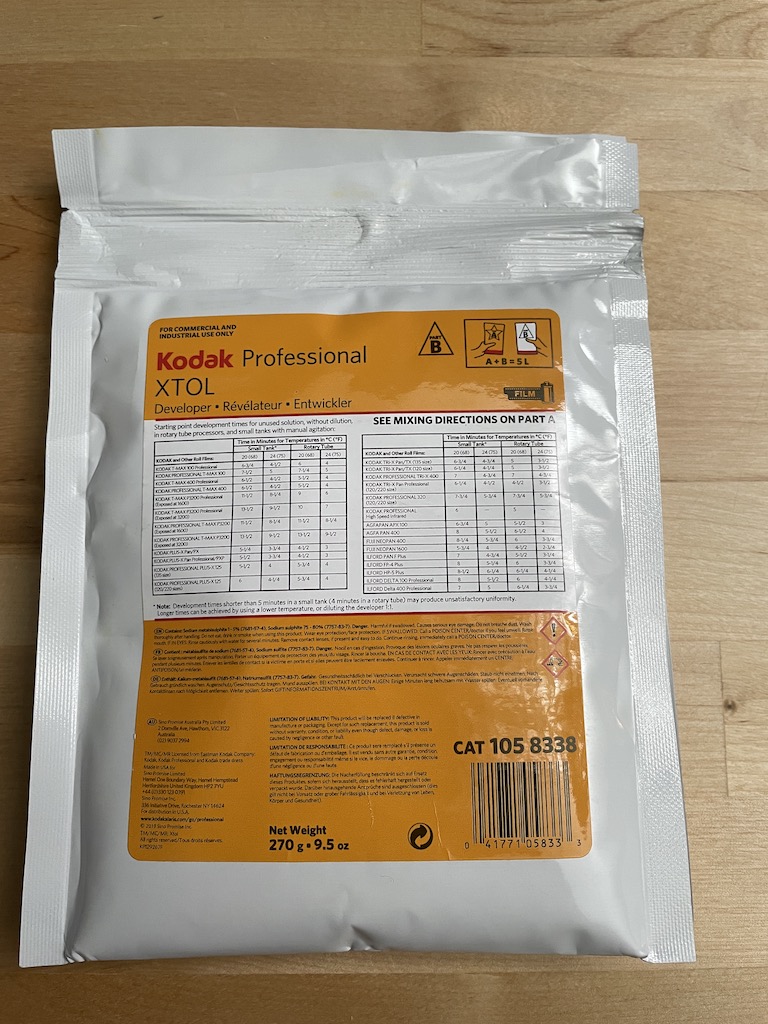

This is what has been shipping out the door for the last several months. It's the mylar type material the same as from before, but the actual satchel is smaller than before.

Thanks Adrian - that is slightly different than the most recent package I've seen.
I note with curiosity and some amusement that at least the front of the package seems to have a label on it that has been pasted over top another label :smile:
