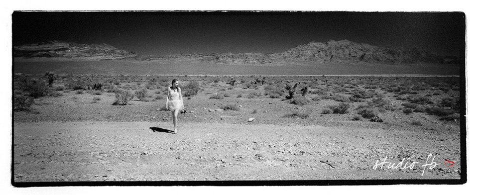

I got some extraordinary shots with SFX200 over time. My last shots were in Death Valley. I still have to print the outstanding landscapes that I saw but the negatives are beautiful so I'm confident that the prints will be beautiful.
Here is one shot I printed the other day, on RC paper, for my wife. I hope it can give you an idea...
Xpan + 45mm + BW092 filter. There is vignetting/falloff due to the lack of the Xpan center filter. I didn't want to stack filters.

I guess it comes down to SFX vs Rollei then? I'll be using a Cokin 007 (which is an 89B equivalent). I guess I can't expect results like HIE, but to be fair, I don't get through a lot of it as we don't get a lot of infra-red in Yorkshire....

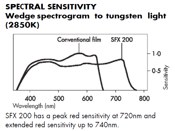

It's interesting that looking at the spectral sensitivity, both Ilford SFX and Rollei IR are actually pretty similar given that one is described as an 'extended red' and the other as 'true IR'. I might treat myself to a roll of each for my RB67 and put one in it's own back and shoot them side by side.

AgX
Apr 5, 2007
29,972
Germany
Be carefull in comparing spectral sensitivity curves of different origins, as long as you do not know for sure how they were obtained.
The IlfordPhoto curve is based on the radiation of an incandescant source of known temperature, the Agfa curve on an eqalized energy spectrum.
AgX
Apr 5, 2007
29,972
Germany
If you make up a spectral sensitivity curve not only the spectral sensitivity of the film itself is of influence but the spectral characteristic of the light source the film is exposed to. One either can take that as it is (typical wedge spectrogram) or eqalize it to same energy, by filtration or calculation.
If only a cut-off frequency is concerned that does not matter. In all other cases one must consider variation of curves.

Wow, I had assumed that it would be equalised to a constant wavelength-independent output source level, as in acoustics.
