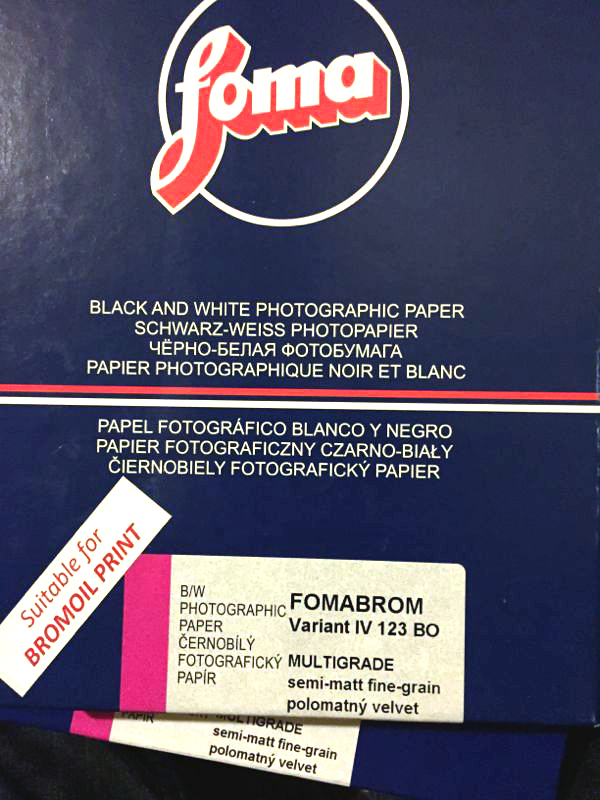

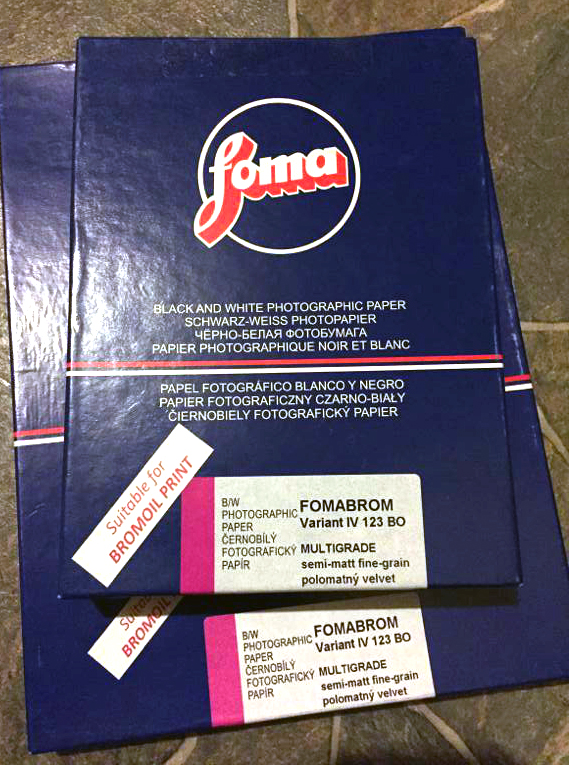

I've ordered the newly announced Bromoil printing paper from Foma:
Fomabrom Variant IV 123 BO
I ordered it in 2 sizes through the webshop of Foma itself.
Fomabrom Variant IV 123 BO 17,8x24 CM/50 sheets = Euro 17.94
Fomabrom Variant IV 123 BO 12,7x17,8 CM/100 sheets = Euro 15.56
(There are larger sizes available too)
Examples from Foma:
It was also announced by Freestyle:
"Fomabrom Variant IV 123 is now a new emulsion designed for Bromoil, lith and other alternatives processes and is not recommend for straight black and white printing."
Freestyle expects availability from July 2017. See:
http://www.freestylephoto.biz/430161-Fomabrom-Variant-IV-123-VC-FB-Velvet-16x20-10-Sheets
TheToadMen
Sep 18, 2012
3,570
Netherlands, EU
Pinhole
update: I received confirmation that the order is shipped. So it is available form Foma now. :smile:
edit: I received it today.
- Fomabrom Variant IV 123 BO - 12,7x17,8 CM/100 sheets (15,56 EURO)
- Fomabrom Variant IV 123 BO - 17,8x24 CM/50 sheets (17,94 EURO)

It might take a while before I can test it myself, but a friend of mine will probably test it sooner. I'll let you know how it went.

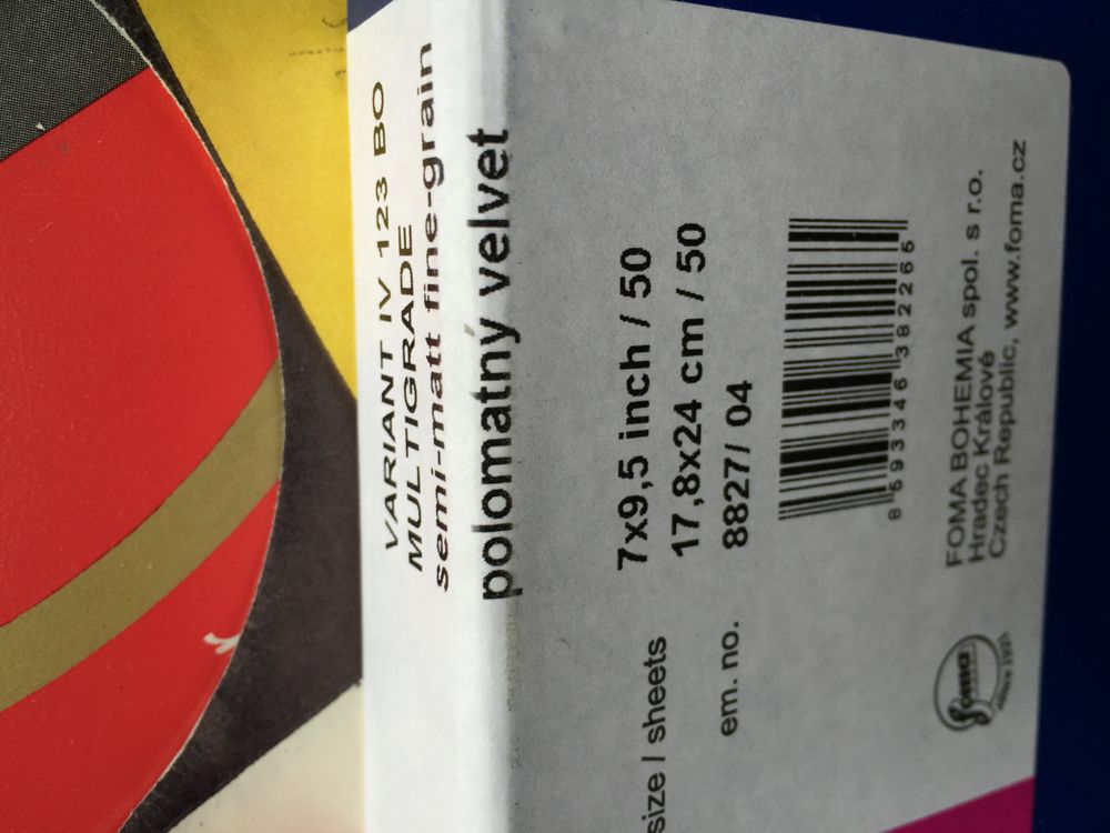

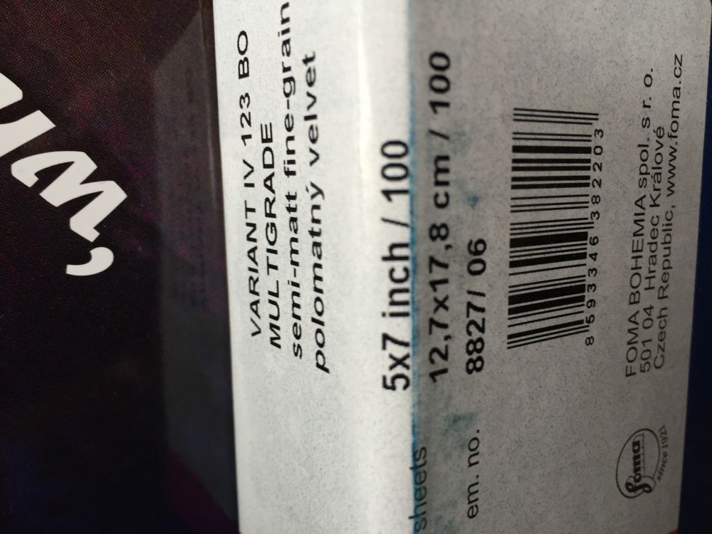

I got some questions about the production date mentioned on the label. Here is a photo of the back side of the labels of both formats with the emulsion numbers 8827/04 and 8827/06.

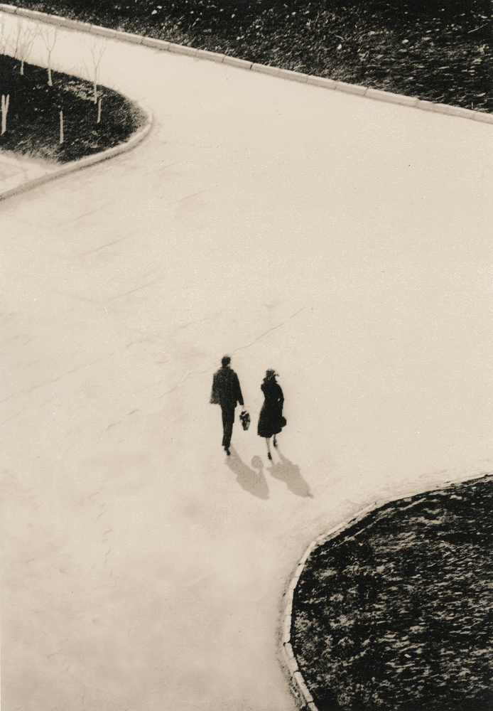

Recently I received a new Fomabrom 123 (BO) paper,11x14". As I undestood it was a limited edition. There is no more this paper in USA. I printed some lith and bromoils on it. In lith there is no difference between the old Fomabrom 123 and new one. In bromoil this paper required to change a little my tactics. Anyway this paper is not bad, but can be purchased only .in Europe .
I am showing my 3 images,printed on Fomabrom 123 BO 11x14"
1)Fishing (lith)
2)Two on the road (lith)
3)I live in a big City (bromoil)
Next time I will try for bromoil Ilford Classic and Fomatone 133

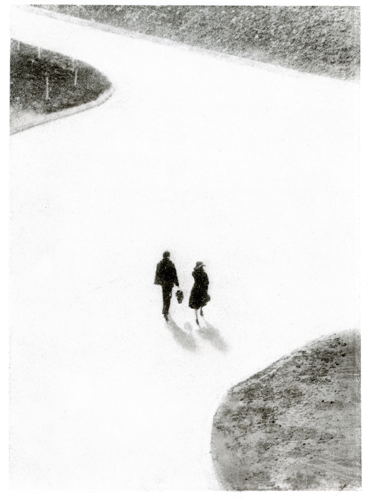

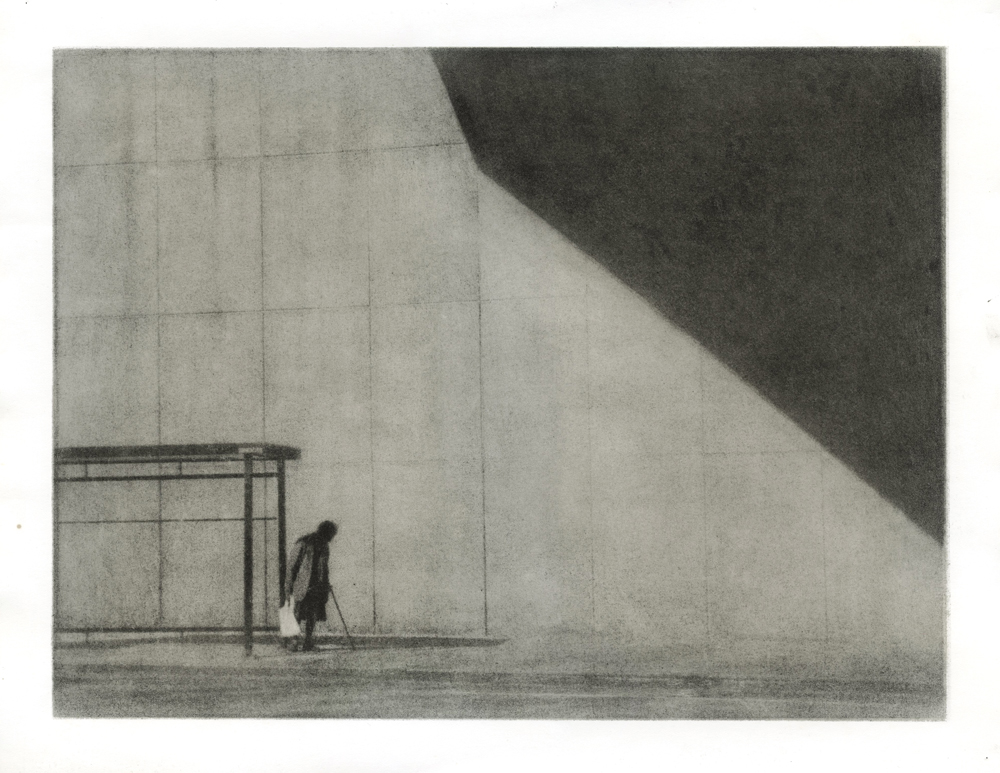

This year I tried bromoil on Slavich Unibrom and Ilford Classic matt. Both papers I think can be tried by bromoilists.
I worked with brushes and Senefelder's 1803 crayon black ink.
1) Two on the road 8x10" printed on Slavich Unibrom
2) still life 11x14" printed on Ilford Classic
