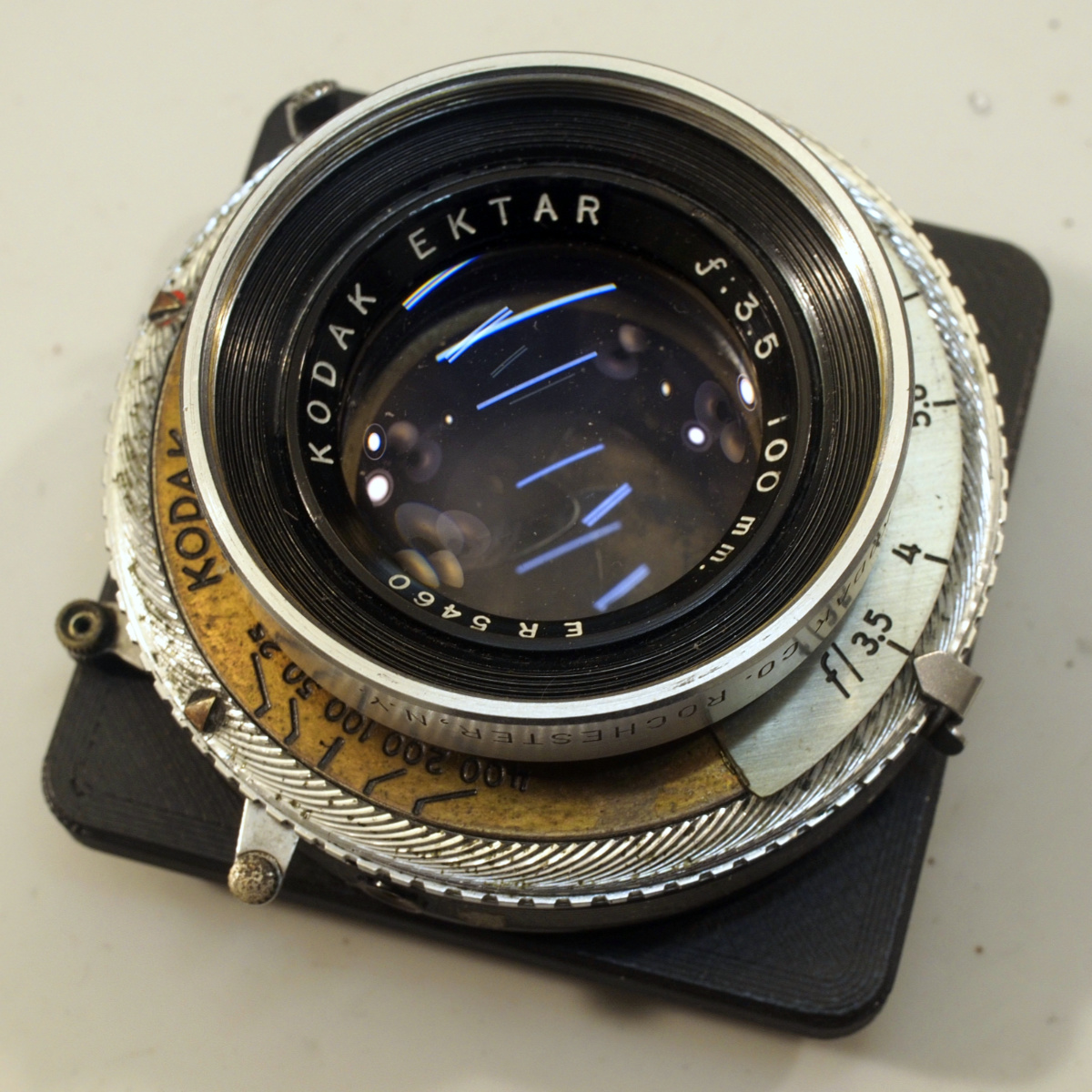

The ektar 100mm 3.5 from a medalist I or II, would fit in the appropriate supermatic or supermatic II shutter from a ektar 127mm ( might me wrong about that) or the shutters are different beasts entirely?
And compared to a zeiss tessar 100mm 3.5 is it not much different( not worth the effort/expense) and while I'm mentioning it how about the skopar 105 3.5?
Yes, same threading and spacing as other Supermatic shutters. Here's one mounted for a Century Graphic baby view camera. I think the original lens for the shutter was a 127, but might have been a 203. I took the aperture off of an original shutter and taped it onto this one since the scales are not the same.
