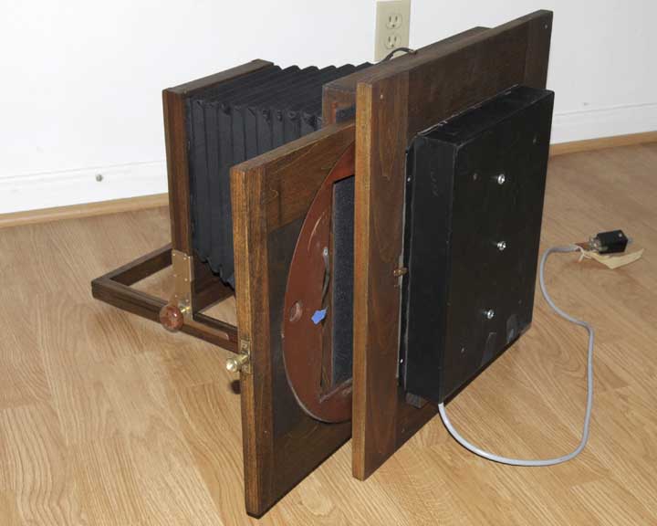

Hi folks, I have recently cobbled together an 8x10 enlarger with an Arista w31 10x12 cold light. I use a roscoe cc40y to enable vc printing (still not spot on with the contrast grades, but I can work with it). The problem I am having is light fall off at the corners. 1 to 1 2/3rds stop difference from center to corners. It's not my lens (240 rodagon) because even without the lens I get the same readings. It is a major pain doing mural sizes (40x50 inch horizontal) because the exposures are really long (5 or 6 minutes) and then I have to burn in the corners another 7 or 8 minutes to compensate for the fall off. Is there such a thing as an inexpensive center filter I could attach to even out the exposure. I tried to make an 8x10 blank print and develop it and then scan the print and try to make a negative on ohp transparency stock and use it as a filter but I'm not having good luck with that. What I was hoping is that there is some kind of center filter I could attach to the lens and be done with it. any thought out there? i would appreciate the help.

Guys, thanks for putting the thinking caps on:smile: I've been out playing with the trout on the green river this weekend so I apologize for being absent. There is no light leaking around the edges of the light. The diffusion screen is a pretty tight fit with a flange to hold it in. The inside is in pretty good shape, paint wise (white) but I do not know how efficient it is. The housing is rectangular which might have something to do with the way it throws light, I'm not sure? I can't move the light any closer to the negative without some serious planing which I hope to avoid. It has an inch extra coverage all around the negative. This enlarger is not "within factory specs":smile: but rather something I have cobbled together. It works fine and is easy to align with my 48x60 inch pegboard vacuum frame. It is portable and easy to stash when not in use which helps with my double duty darkroom/office. I enjoy it, but would like to figure out how to get more even light to make printing simpler and waste less paper if I can help it. I'm trying to avoid buying a new bulb if there is a fix. I would hate to buy a new bulb and have the same situation with fall off. Here's a couple pics so you know what I'm dealing with.
regards
erik
