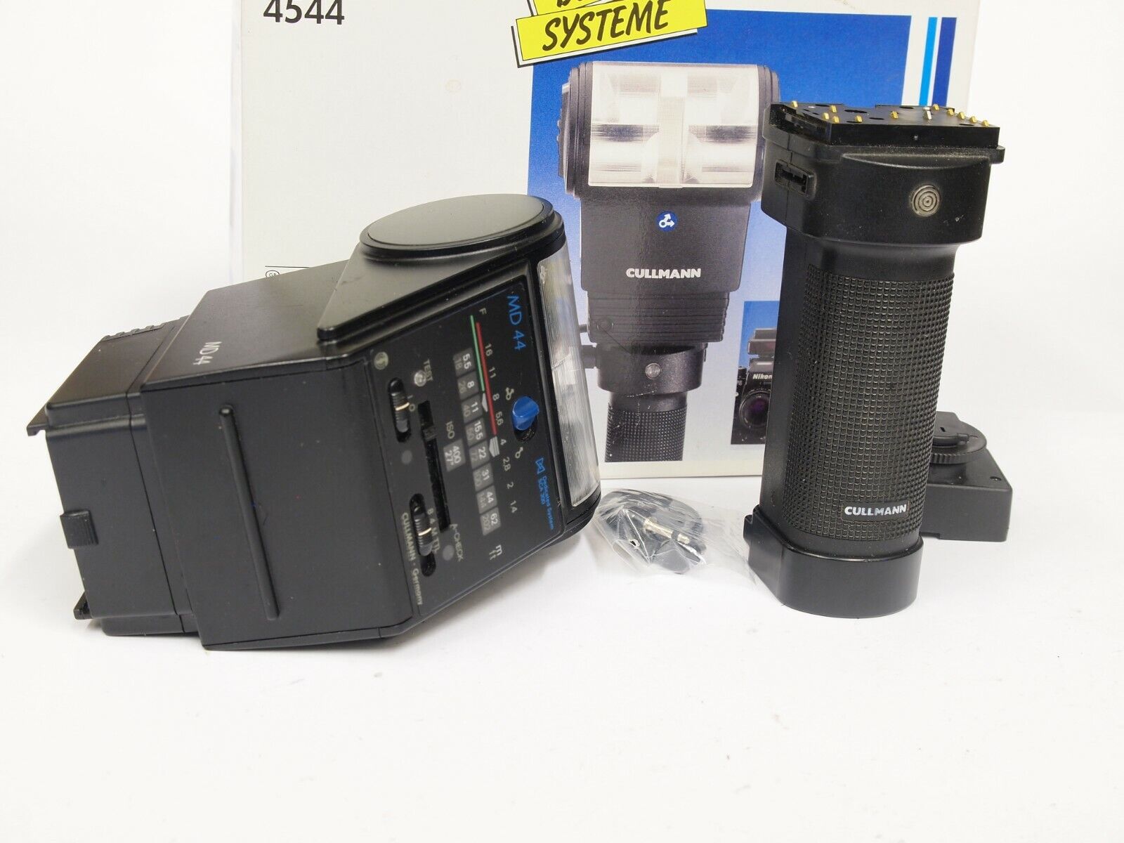

This is what I have:

I originally bought it with a Canon Eos 100FN back when they were both new on the market
It came with a data cable that would either disconnect into two parts where one part would connect to the flashgun and become hotshoe mount, or connect as one piece data cable that connected to hotshoe and the power pack 4544. I assumed it was TTL flash as there is a setting on the main flashgun for that
Kinda hoping I can still get TTL flash on my Nikon, even though it was originally bought with Canon
I'll see if I can get a shot of the hotshoe connector end that may help clarify

From what I see at your photo it seems you got that undedicated adapter.
As I said flash-TTL for you Nikon camera will be no problem once you got the right adapter. That handgrip will allow you to use the Metz TTL cable for off-camera use of your flash, but for this you need Metz cable "300 A", that will be mounted on top of the adapter, instead of the flash.
The cable you describe is puzzling me. It makes no sense to combine sync/data cable with the charging cable.
But a photo is worth 1000 words, well 997...

Has anyone an idea what that sensor(?) at the top of that handgrip is for?
I think I got it: slave-(sync)sensor
The Metz grips have not got such...
