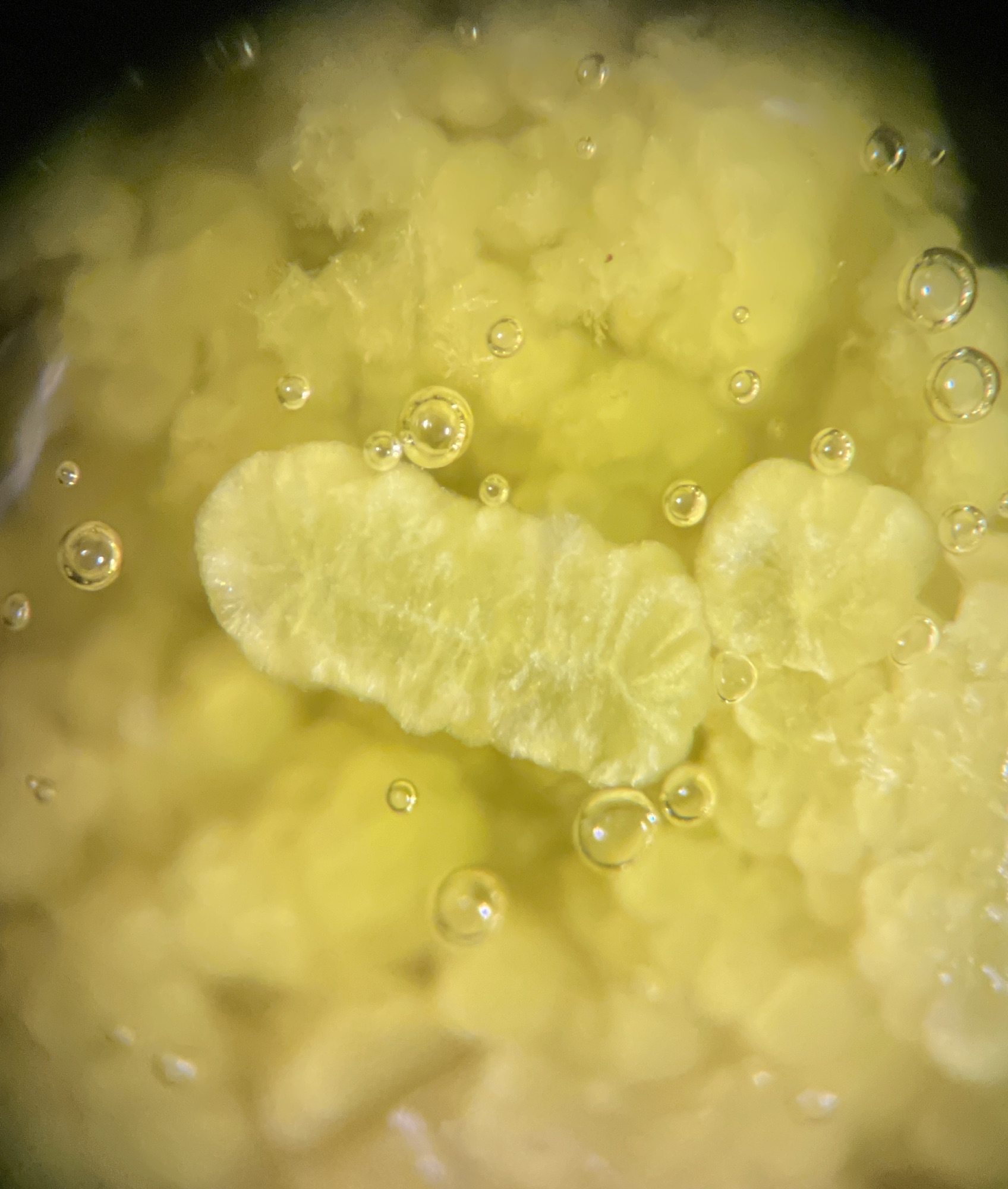

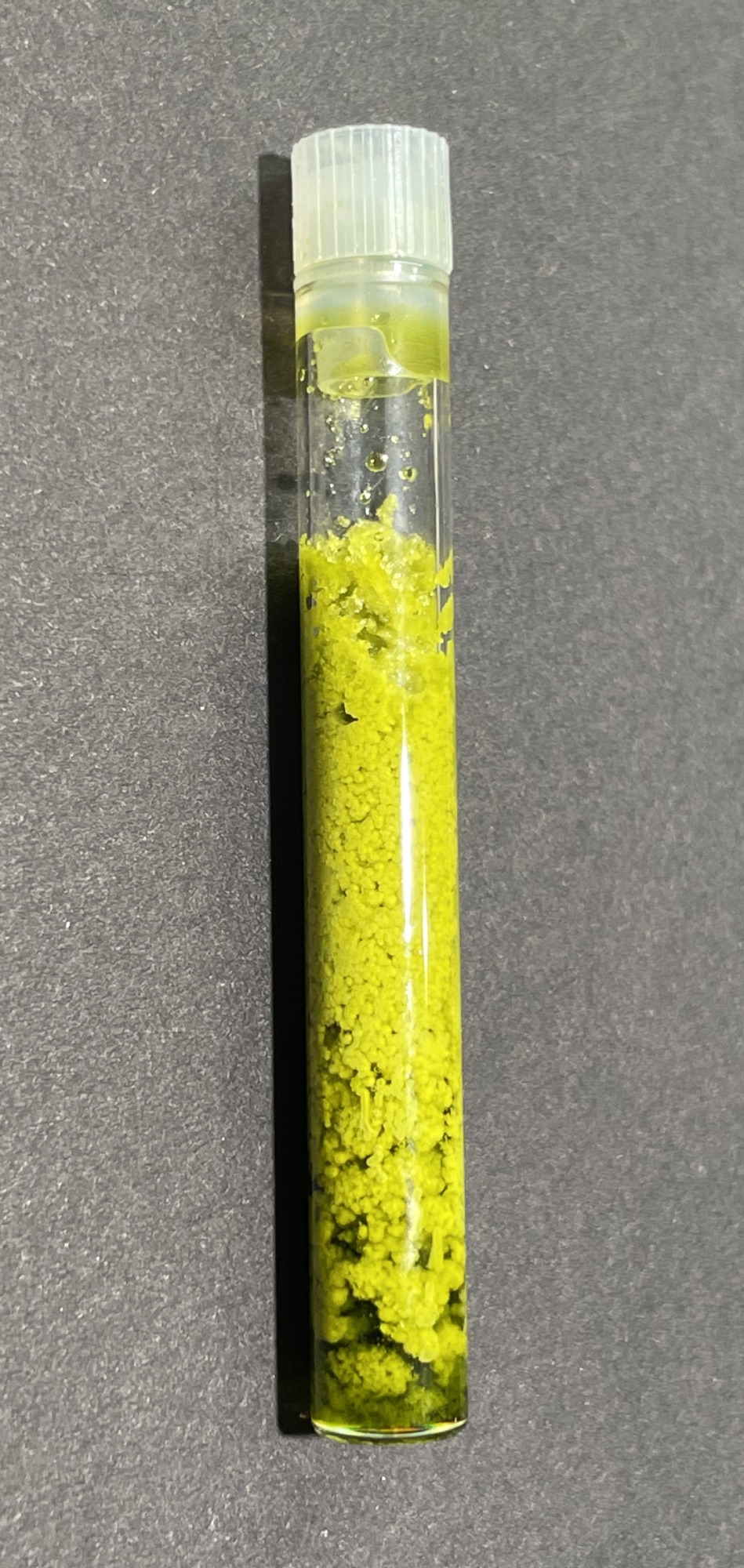

This was a side project of mine in an attempt to see if simple cyanotype (simple FAC) could be made without the additional byproduct salt of ammonium nitrate. I thought that there may be a way to replace the oxalate in ferric ammonium oxalate (FAO) with citrate by precipitation. I used calcium carbonate.
I first added citric acid to the FAO. Then added in calcium carbonate with continuous stirring for about 20 minutes. Once all was done, I tested for free oxalate with calcium acetate (calcium chloride does not work), and free calcium with ammonium oxalate. If either produced a precipitation, I added a bit more of the opposite salt. I left it overnight and checked again. Once free of either, I left it to decant for a day and drew off the supernatant.
I left the mixture to dry to the point of a tarry residue and scrapped that up with a rod and placed it into a small glass vial. I placed this in the fridge for a week and noticed what looked like a small opaque mass, not being sure if this was crystals. I left it in the fridge for one more week, and checked again -no change!. I then removed the vial and left it at room temperature for a few days. I checked it again and there was significant crystal growth -the masses growing like cauliflower, which eventually filled the vial. It seems that the warm up accelerated the growth. Upon removing some crystals, adding a bit of water and letting it dry, the crystals did not reform on drying on a glass slide at RT, RH 40%, forming a glassy film. It seems that very specific conditions are needed to get crystallization.
Here are the amounts I used:
10 ml distilled water
2 g Ferric Ammonium Oxalate (FAO)
1.5 g Citric Acid
2.25 g Calcium Carbonate
I proceeded to make a test print. The dmax was less than simple cyanotype (Ware). Then I added a small amount of ammonium nitrate, which I had to make, as I don't see it available to buy, the dmax improved. It seems that the ammonium nitrate in the simple cyanotype is making a contribution. I have also used this approach to make ferric ammonium lactate and it worked quite well, but did not attempt crystallizing the FAL.
Peter Friedrichsen
close-up
