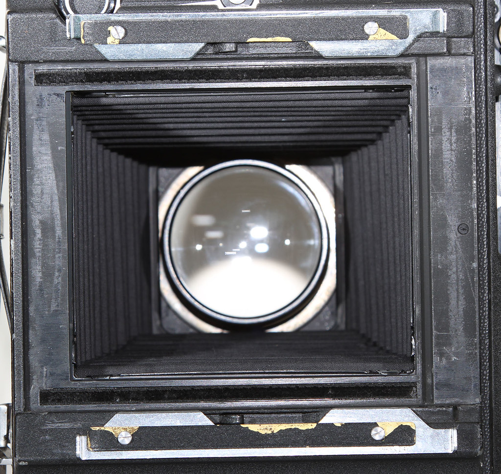

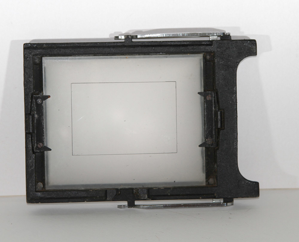

It sounds like you already have a graflok back but are missing the ground glass panel.
Does the back of your camera look like this? If so, you have a graflok but are missing the panel

The panel looks like this:
IMG_2007 by Fotoguy20d, on Flickr

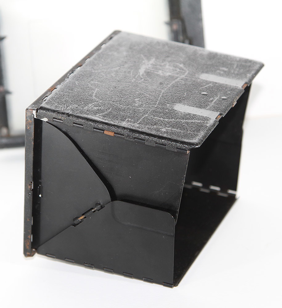

and could have a hood like this:
IMG_2008 by Fotoguy20d, on Flickr
I might have just a panel available if you're interested.
Dan
bkschnitz
Sep 9, 2011
4
Yes! I am missing the panel. Thank you for putting these images up - it is very clarifying. Are you looking to sell the panel/hood? If so how much for?
