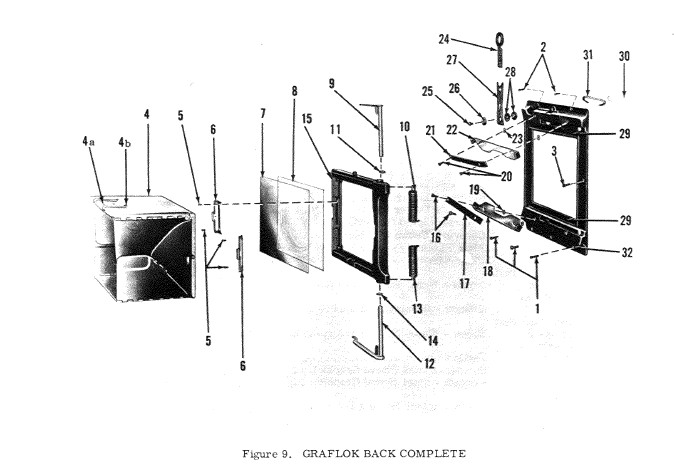

Now to give yourself the best chance remove the ground glass and fresnel from the camera back by removing the focusing hood item 4 by pulling on one side or the other of it
then remove screws item 5 and retainer clips 6. Remove ground glass 7 and fresnel 8 handling 7 & 8 by the edges only.
Wash each in warm water with dish detergent rubbing gently with your finger tips only. On the ribbed side of the fresnel rub with the groves only never across them. The amount of pressure applied with your finger tips should not be sufficient to move the skin on a very ripe grape. Rinse thoroughly in running water then rinse in a weak photoflo solution then stand on edge and allow to air dry.
Reassembly order is fresnel-ribbed side up, ground glass-ground side down with the focus frame laying flat on the work surface. Install retainer clips and screws, adjust so they hold the focus hood firmly and snug the screws. Do not over tighten the screws.
