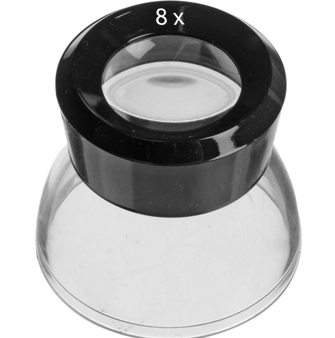

I have used my Pacemaker Speed Graphic as a view camera and used the front rise to correct the perspective. I use a black cloth and a loupe like this one.

I use the same loupe as the pic posted by SiriusG. Blessed with long, skinny fingers I can use that with the folding hood in place and a dark cloth to get rid of other extraneous light. I tend to worry only about checking focus in the middle of the frame... perhaps because getting the loupe into the edges and corners is a bit of a pain and just not worth the effort. As arthritis is starting to set into the finger joints I may need to look into one of those long loupes, though.
I could definitely use some long, skinny fingers. Do you have any to spare?
attachment.php
Yep.. and scotch tape a TP, center cardboard tube to it, when the roll is done.. :D
Works very well, and is inexpensive
