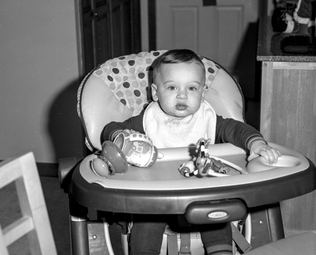

What I did after changing the cam was to pull the lens out until a house well over 100ft was in focus on the gg and then locked the lens down and checked using the rangefinder and it appears to be ok. I took a picture of my grandson using a flash and rangefinder and it came out nice, so I assume the cam, rangefinder and lens are on target. Or am I missing something?
Here is the picture, I think I was around 6 feet f16 Did I miss focus?

Your missing something. Does the camera focus true over the entire focusing range? Not just at 6 feet?
This was the only shot, the flash didn't fire on the other . I need to load more film holders. Does this picture look out of focus to you?

The overall focus looks soft but the child's eyes are fairly sharp. Looks more like a f5.6 to f8 than an f16.
Camera shake, soft scan that needs sharpening.
Test the focus with the lens wide open on a tripod using a test target at several distances. Rangefinder calibration distances are infinity, 25 feet, 15 feet, 10 ffet, 8 feet, 4 feet.
Download some of these https://www.google.com/search?sourc...hVFrJ4KHQN9DfIQjJkEegQIBxAB&biw=2176&bih=1111 print several copies at the printers highest resolution and mount on a piece of 20x30 inch foam core, focus on the finest detail possible for each distance.

Thanks I try that over the weekend. All my b&w shots seem soft even when using Hasselblad, Bronica or Rolleiflex, but I am comparing it to digital. My eye sight is not the greatest but I think it's my scanning and can't figure out why. I have a V700 and before that a 4490 and I even bought an adjustable film holder with anti newton glass and tried the lowest to highest position with very little difference. They all look much better when printed but still not really sharp like my digital, but I like the overall general look better than digital for b&w.
