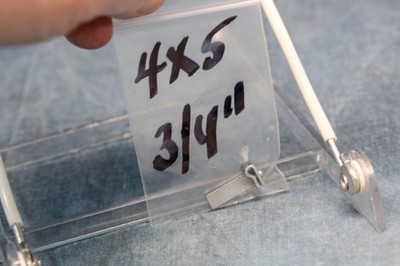

I have a top rangefinder model. I'm actually ok holding the camera "press style". I am missing that little level/cam that goes press the lens' shutter lever. The vertical rod is there and goes up and down, but nothing pressing the shutter.

I hear you. My 210mm for portraits works fine, I would like the camera to be used as originally intended when I use my 90mm. So that missing paddle bothers me.
