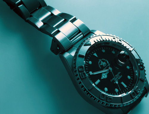

Hi Steve,
Yes you can get respectable results. Tends to be high contrast, like most cross processing.
Attached is XP2 in Tetenal E6
Best wishes
Dave
A few years ago I did it with Kodak's chromogenic b&w film. It needed to be over exposed by a good many stops (at least 4 if I recall correctly) and produced a beautiful cyan tinted slide that was projectable. I also tried lowering the pull and increasing the development, but the highlights went pink.
