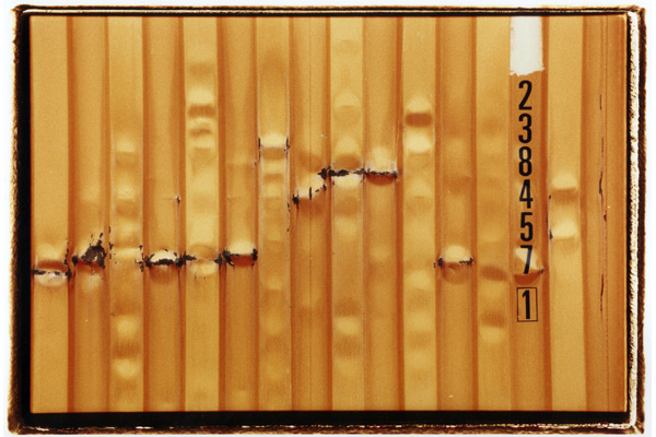

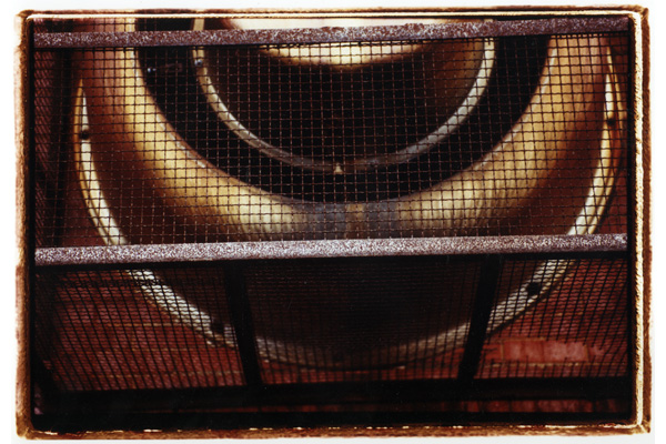

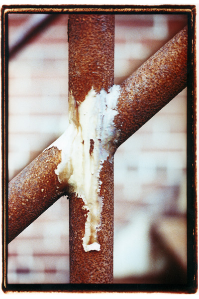

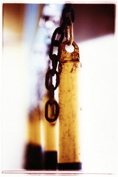

Here's a couple of shots I printed from E100G cross-processed (note that they may look different on your monitor than the actual prints). Most of my info on the subject was gleened from John Callow's (another APUG member) workshop at the APUG conference so he'd be a better person to ask than me.
The quick summary is that you tend to get really saturated colours and very contrasty results. You also tend to get some kind of colour cast which you may be able to correct for while printing or you can correct for it when taking the shot (as I did in all of the above), or for that matter, you might like the effect of the colour cast.

Yes, E-6 film (Kodak E100g) in C-41. Just in case you don't know, E-6 in C-41 will give you negatives without the usual colour mask since it's from a slide film that doesn't have the orange mask. C-41 film in E-6 will give you positives but you'll have the orange mask so will probably be less useful for you.
