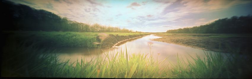

Pinhole
This shot was made with my wooden 6x18 cm pinhole camera on expired Velvia 50:
The film is expired about 8 years ago and wasn't stored properly at all!! But stil very usable indeed.
So please try one film the "normal way" before you decide. It might surprise you.
